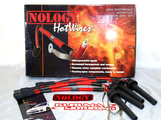

So, I'm about to do my sparkplugs and decided to do a little research on ignition coils. Are they worth upgrading? I found them on ebay ranging from $70 - $750 (for plasma direct) that apparently will supply 10x more spark.
What should I know about ignition coils? Are they limited by the spark plugs, or are the sparkplugs limited by the coils?
OKADA Plasma Direct Ignition Coil $750
Nology Hotwire Coil-on-plug Conversion kit: $220

I don't see a reason for the upgrade unless you are pushing massive amounts of power you don't need those. They are horribly expensive too IMO. There are other things you can do for that price that are more worthwhile. I've also read you need a tune after you install them or you may throw a code. You also won't feel much if any power increase.

those products are both garbage. nology is a very old scam i thought everyone knew about, and the okada ones are unreliable. members on here had em and they barely lasted a few months before one failed. the oem coil on plug ignition is already a huge upgrade over wires and they last near forever. many guys run stock coils with 400+hp civics and have no problems. stick with parts that have been proven to perform for 100k+ miles not some random junk that nobody is using. i guarantee if they were that good, they would be coming stock on new cars. same goes for the pulstar spark plug junk. companies will come up with anything to make money.

I gotta say those first ones look nice though Not 750 dollars nice though.
