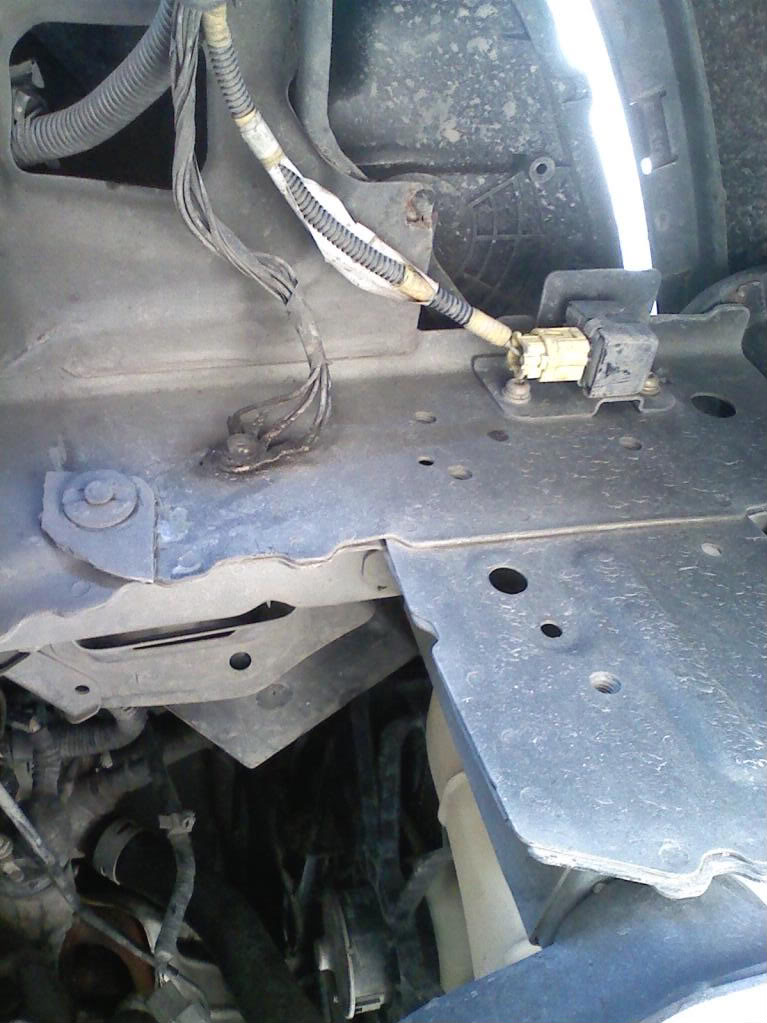

That doesn't sound like a bad ground, it sounds like you shorted the ECM/PCM somehow.
Take that ground off, clean it again good AND the part of the chassis it grounds to, put di-electric (contact grease) on it, then make sure that it's screwed on tight.
@ Riceboy: Behind right inner fender under the headlight. That sensor on the right is the impact sensor.

^^^ all the mentioned bulbs and some other items use G201 for grounding and that picture is of G201. That is a much better picture than in the manual.

Did you see the body pin and what's left of my inner fender?
