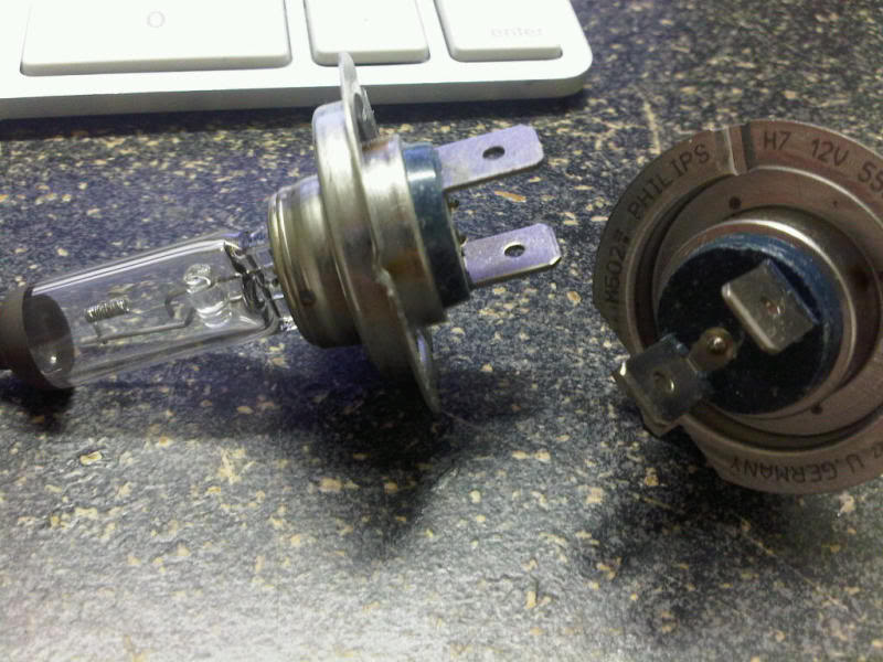

i will make a DIY within a few days from now about it. i have both LED + H7 bulbs.
as for the LED reverse tail light, u can use a drop-in FLASHLIGHT led (R5, R2 and Q5 leds are good. they produce anywhere from 200lm-300lm). they accept anywhere from 3v-18v (safe for car's fluctuating 11v-15v)
heres a pix of the drop in flashlight led (for a surefire)
or, if u want something that will produce about 1000 lumen, put an H7 bulb in there. they are 55w and the stock wires should be able to handle them. its not like u will be leaving them on for an hr. (how long does it take u to reverse? 20sec?)
if u notice on the h7 bulb, there are two prongs that come out. u can use quick female disconnects and tap into the +/- wire of the reverse light. and bam! instant.
and since the H7 bulbs last for about 500hrs, u should be fine without replace it any time soon.

thats if u put the H7 halogen in there.
if you put a 6000k hid bulb in there, its gonna be suspicious.
You could retrofit HIDs into EDM rear fogs and make it slightly more stealth.

The thing about adding H7 bulbs to your tail light is just making an accident waiting to happen
If you have a serious tailgating problem, adding a bright tail light would be dangerous
Imagine if you're driving behind someone, and you get a camera flash of light
The driver would be blinded for a couple of seconds, and driving at high speeds...
Well you get the picture
Reverse lights aren't supposed to be overly bright, thats why I suggest the LEDs.
You arent meant to "see" in your rear through your tail lights.
and another reason why I suggest LEDs are because they are directional, they shoot out, as opposed to needing to be reflected, perfect for reverse lights.
