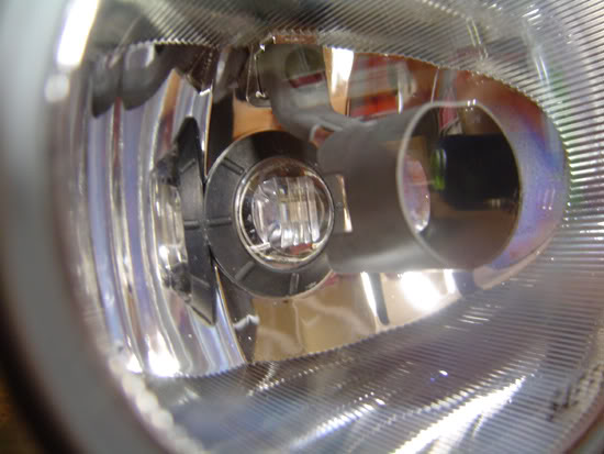

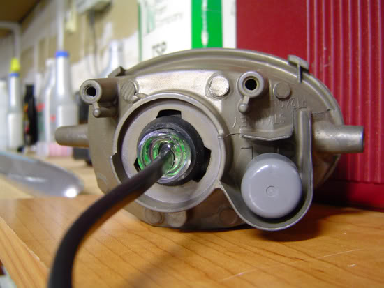

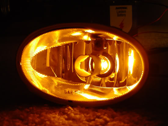

Re: What bulbs for H8 fogs?
pretty much no. if you decide on the leds to turn em into park lights, the maxxima 3/4 inch modules are a perfect fit in the bulb hole using the supplied rubber grommet. no cutting required. they have these all over ebay and they come in many colors. i got the clear lens amber version. there are a couple small holes after you mount them which can be filled with some of the 3m butyl. i have the same module in the headlamp so its a perfect match at night.

Cool, that looks good!

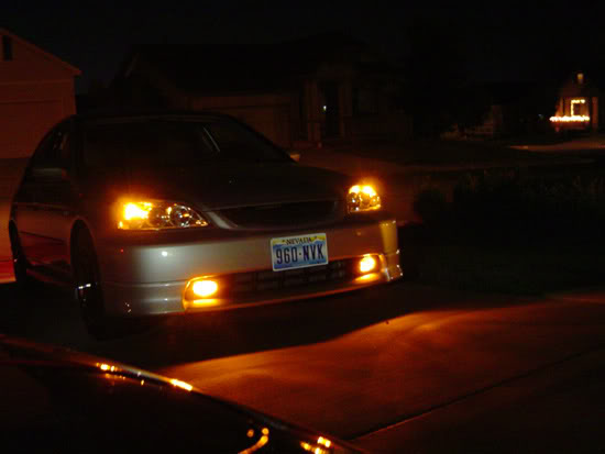

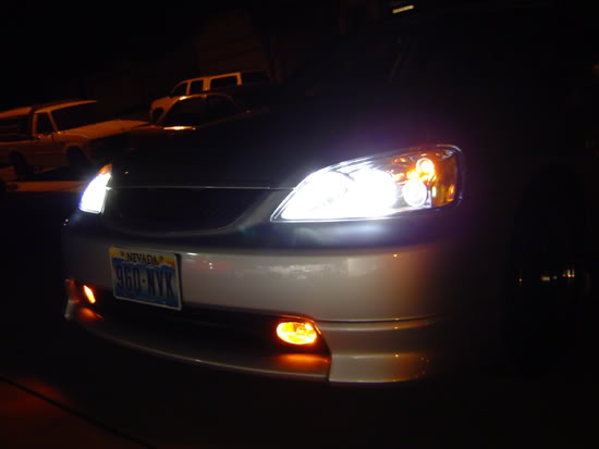

its a good look with hids for sure i have a pair of white led version but ended up using the amber. and i have the fogs hardwired to the park lights so they always turn on. led clusters are super wide angle but the reflector fogs help to bounce the light around too.
