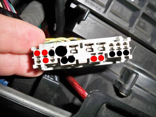

So I finally got some time yesterday to get in and take a look (kinda) & I light tested this connector-
RED= NOT working
BLACK= Unused
Multiple wires with no power = common source right? and since my gas meter is fluctuating and a few other lights are working...? Any insite is appreciated, and to ahhhonda- i haven't been able to get my hands on a voltmeter yet, would this still be a symtom?
