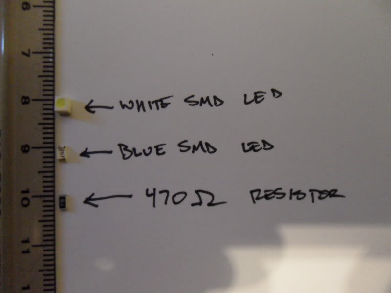

just gotta be careful if you decide to go with the SMD (surface mount device) route.. They're hella small and easy to fry/lose. I think I lost and/or fried at least 5 resistors and 3 LEDs. The LEDs mostly because I forgot to put a resistor on the positive line while testing them with my 12VDC power supply.. Either that or they stuck to the iron
here's a reference for how small the components are
That the cm side of the rule, BTW. The amber SMD LEDs are the same size as the white ones, and I doubled up the blue LEDs (soldered together in parallel) just because I wanted the extra brightness.

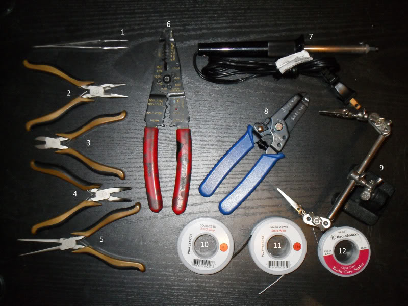

And here's all the tools I used
1 - Needle point tweezers
2 - Mini Long Nose Pliers
3 - Mini Diagonal Cutters
4 - Mini Bent-Nose Pliers
5 - Mini Needle Nose Pliers
6 - Electrician's Pliers (Mainly used to hold the bulb bases)
7 - Fine tipped soldering iron (I used a 30W iron)
8 - 20-30awg wire stripper
9 - helping hands
10 - Solid 20awg wire
11 - Solid 26awg wire
12 - Rosin Core Solder (I used .032" diameter solder)
Only things I bought to re-do all my lights was the SMD resistors, 20-30awg wire strippers, the tweezers, and the solid wire
