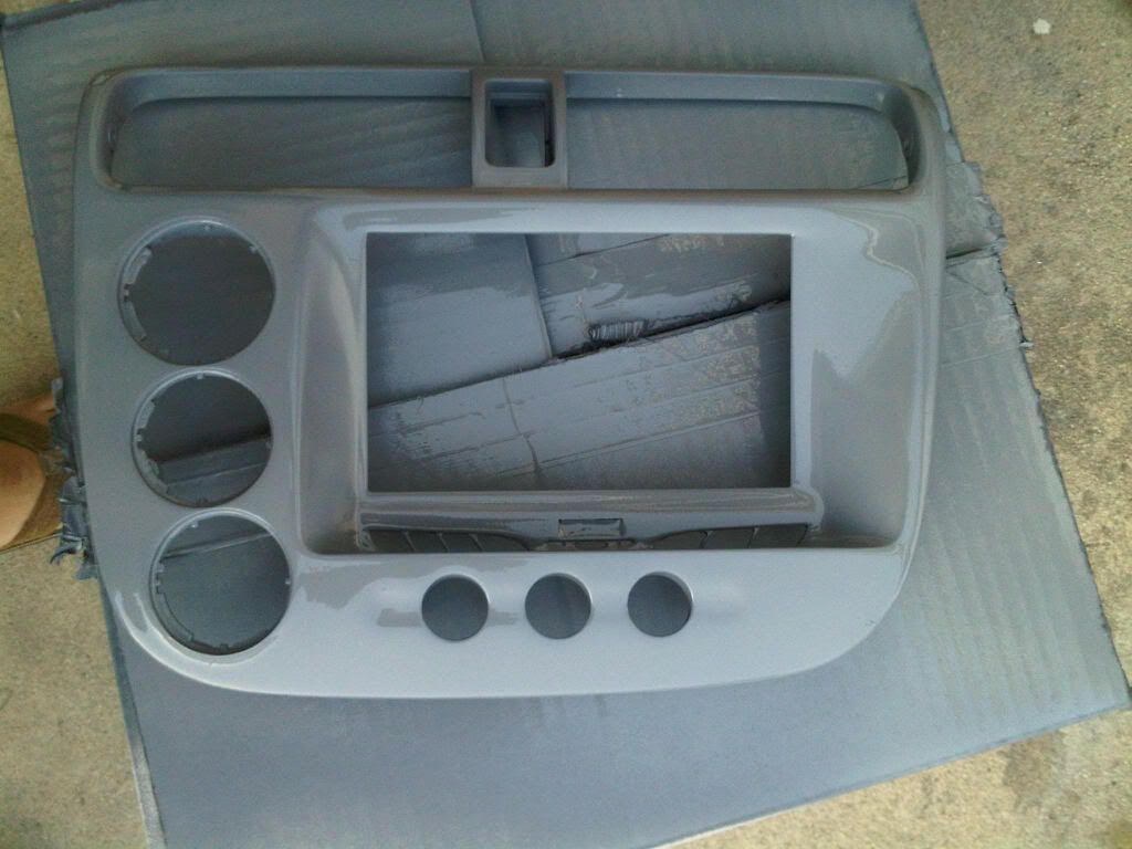

here is my most recent mold. its for my new led backlit touchscreen.
as you can see, i tilted the screen down a bit for a better and easier viewing angle.
this is the primer'ed product. still needa paint it...
