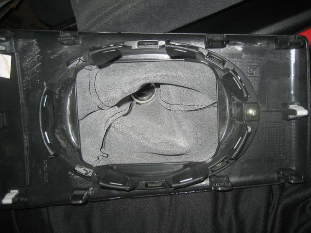

2. Remove the Gear Shift Trimpanel. First push down (towards bottom of car) on the chrome ring underneath the shift ****. Then unscrew the shift ****. Here you can see the little arch you get your fingers underneath the Gear Shift Trimpanel to pry it up. This is on the front of the panel facing the cup holders
3. Here is the bottom of the Gear Shift Trimpanel

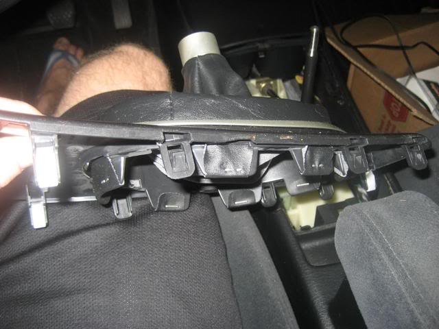

4. Here is the side of the Gear Shift Trimpanel

5. Here is what it looks like without the Gear Shift Trimpanel

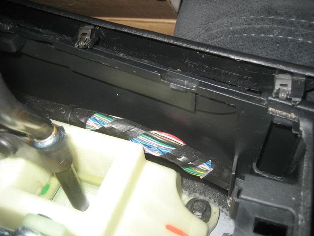

NOTE: I believe I pulled up (towards the roof) and then back (towards the trunk) to remove the Console trim
8. Once removed, here is the back of it. There are two clips on each side. One of my clips fell of, but I found it back and pushed it back onto the panel

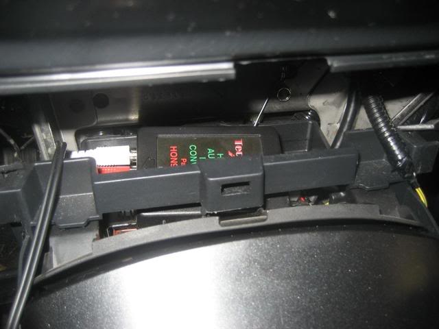

9. Here is the box plugged in hanging free. The plug is to the right of the radio when facing the radio
10. I placed the box flat inside the dash. I doubt it wil go bouncing around. The aux plug on the left and the other cable on the right keep it stuck in place

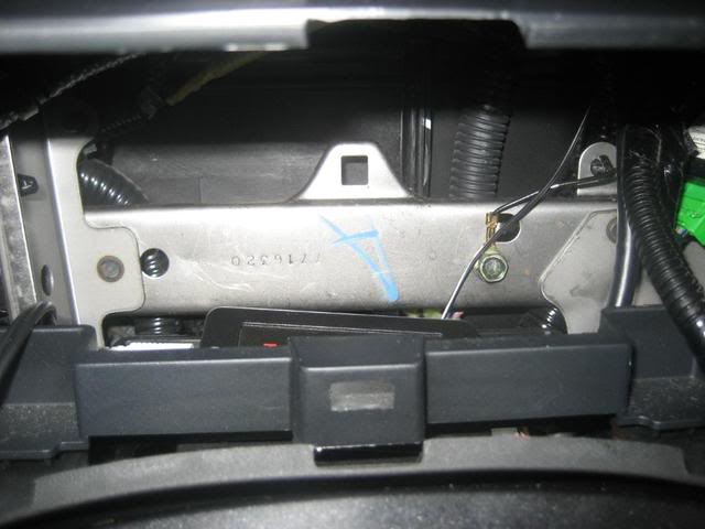

11. If you want to ground the device, there is a screw to the right seen in this picture. I did not ground mine.

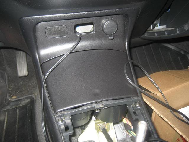

12. I then replaced the Console Trim

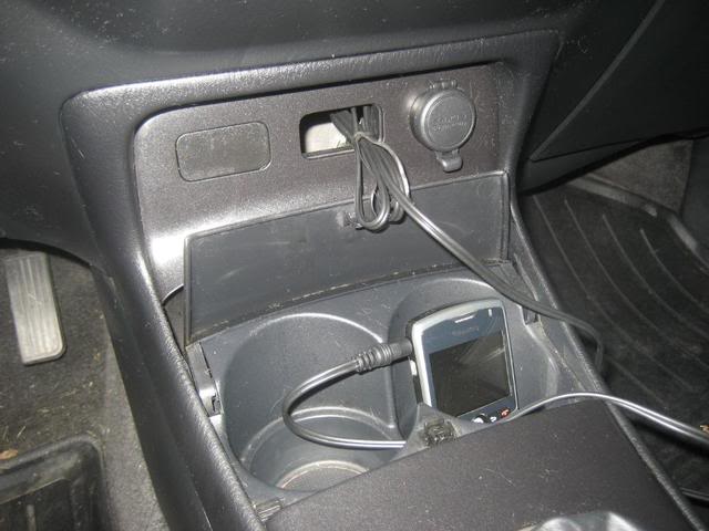

13. All wrapped up and ready to play!

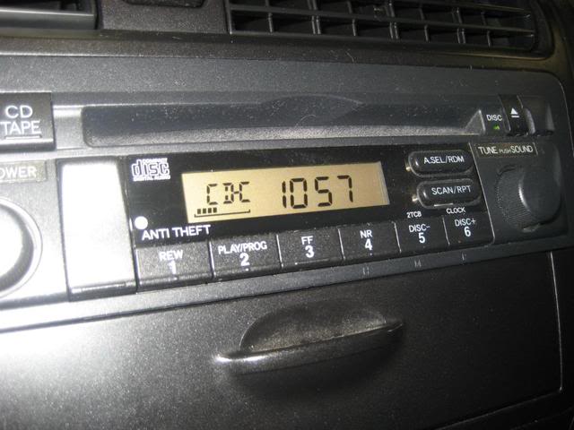

14. Press the CD/TAPE button twice to get to CD-C mode, and you're ready to go.
