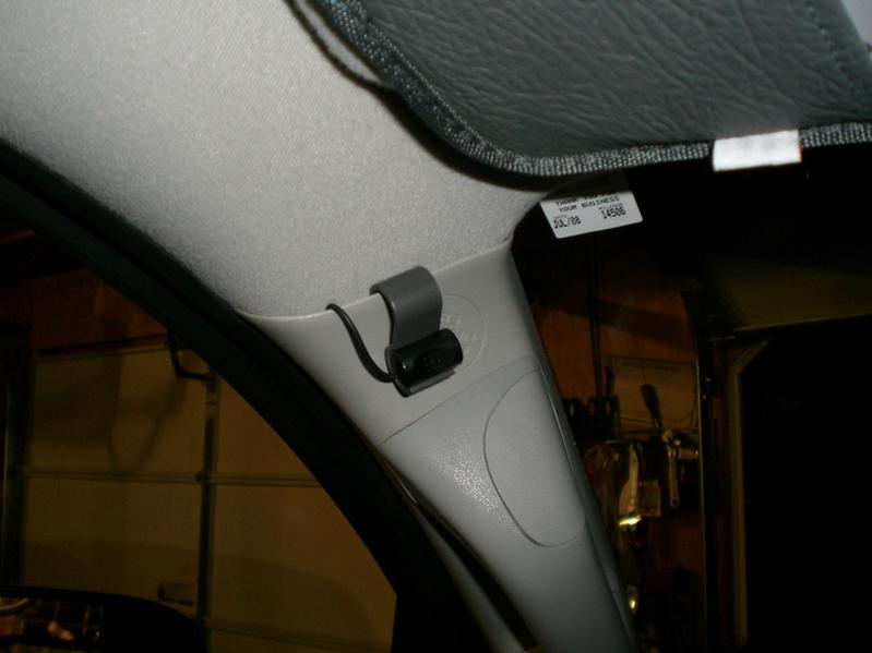

This is what I am talking about, it's not in a Civic, but that's the idea. I've never pulled that front cover off and I don't even know if there is space to snake wires up from behind the dash. Any ideas?

If it's just a microphone to speak into, why not take your gauge cluster bezel off and mount it on there and slap it back on? To take the a pillar off it should just pop right off. Be careful but don't be afraid to use some force. Your may need to remove the dash to fish the wire through but you should have enough room behind the cover to run the wire and mount it.

I placed my mic behind my rear view mirror
You will have to run the wiring from behind the deck under the steering wheel bring it to the side door up the side (you will have to take of the rubber insollation thing and under the cover of the top. I did mine i dont know how to explain it but its just running it under and making sure you cover it up well ..
