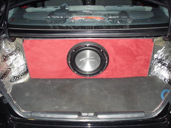

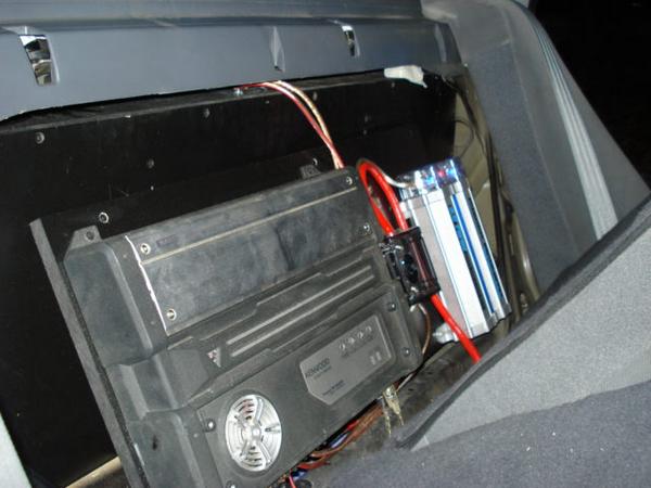

Need to find my charger for my dig cam and i will be back on with another post with full detail pics on the amp install. heres what iv done to mine. By the way i do make custom boxes for all cars.
