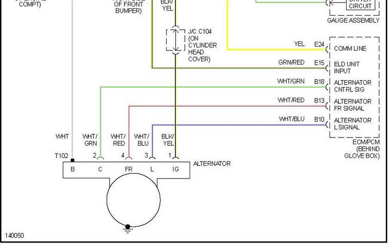

Does anyone know of an aftermarket alternator for our cars that uses an outboard voltage regulator instead of using the factory ELD?
do you have a schematic of the factory one? maybe we can figure a way to improve on it?

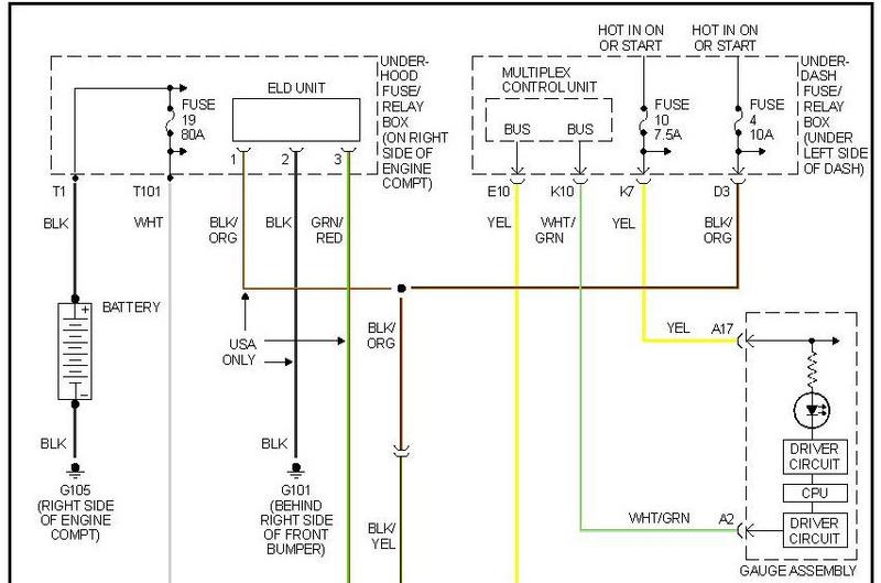

Re: Should I upgrade battery or alternator first?
One of these links should work as a wiring diagram.
Anyway, the whole issue the way I see it is things like amplifiers don't draw current thru the ELD. The amp's power connection is straight to the batt so it bypasses the ELD. So, the ECM/PCM doesn't tell the alternator to work any harder to make up for that power out of the battery.
That's why an outboard regulator seems crucial to me.

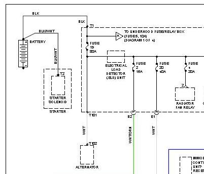

And this one might explain how the ELD is wired into the vehicle a little better.
