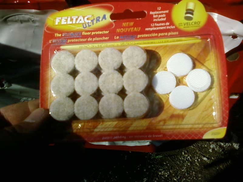

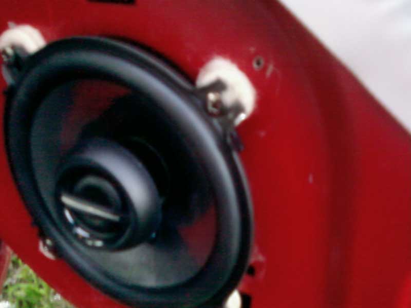

I used these for spacers. worked like a charm. $3 @ Canadian tire

^^but by doing that, with the gap between the speaker and the door like that, it will SEVERELY affect the sound quality. Try making a solid ring spacer and listen to the difference, you will notice it.
I just made my spacers out of MDF and trimmed it a little here and there with the dremel until it fit like a glove. Once I had those in, on the back side of the door panel youll see some extra plastic around the speaker grille, just trim that up a bit to allow for the speaker excursion. I mounted my MB Quart components this way and I love the way they sound.
But yes...read the sticky, it has a lot of other imfo you might need as well.

I didn't notice any difference, I used to have a 1" mdf ring, but it was a little too big, and the speaker used to hit the grille on the door panel, so i just used these, it sounds about the same.
