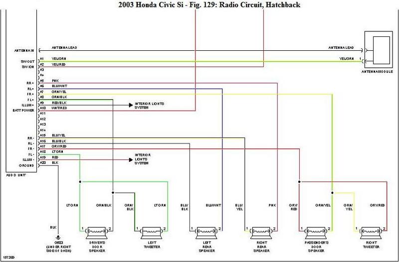

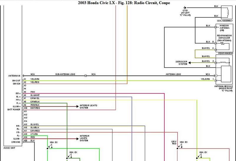

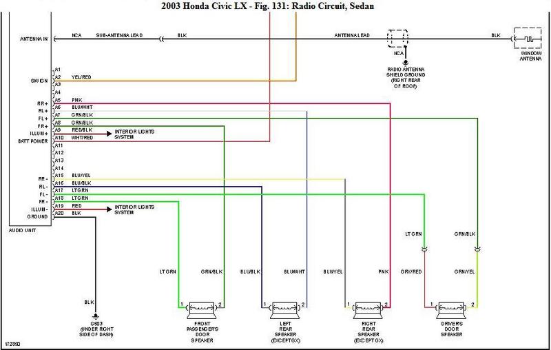

Originally Posted by Eskimo10
Ah ok, I thought something was missing but her wires weren't labeled like they were in mine, I should have known lol
So what's the deal, did you ever get a resolution on this?
Originally Posted by electric130
is this only for coupes? or will it work for sedans too? is there an amp for sedans?
The coupes have an antenna amplifier, the sedans do not. It looks like the Si has the turn on wire for it but it isn't the same as the coupe. I have no idea as to the reasoning behind it all. Feel free to take a look at the wiring if you like.
