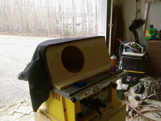

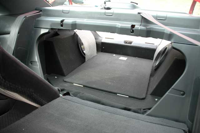

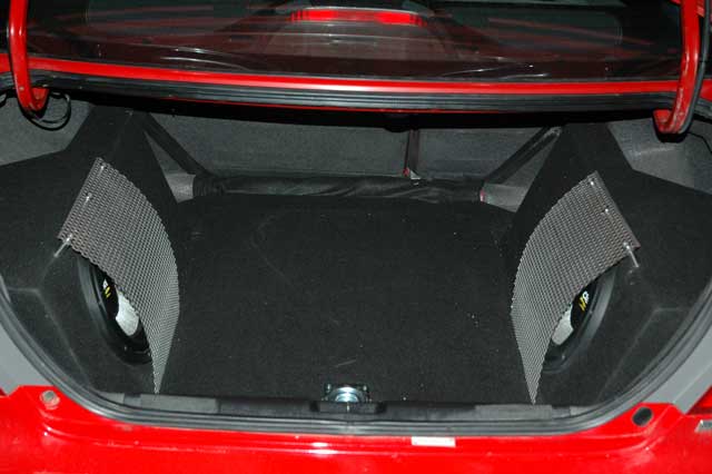

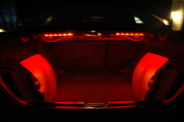

I just finished My trunk on Friday. it took me a good 10+ hours, working on my spare time, but I finally finished. I started because i got sick of carrying stuff in my back seats, and i could not fold the seats down, so i went from a huge waste of space at the back of my trunk, to two slightly less wastes of space on the sides. now i can fold my seats down and carry "long" stuff (golf clubs, hockey stick, snowboard) Also when I said 150$, that did not include the actual stereo electronics, that was in there before. I spent:
33$ on a sheet of 3/4" MDF [RONA]
22$ on 6m of felt [wal-mart]
20$ on hinges, screws, lock [ home hardware]
25$ on led light [wal-mart]

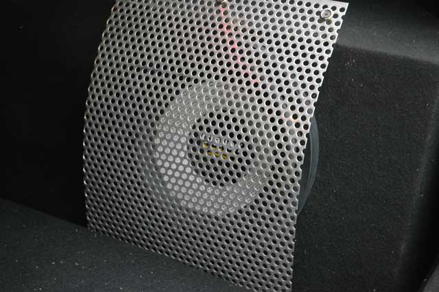

35$ on 2 11x15 sheets perforated stainless 22 ga [Arc-tec welding]
0$ on random scraps of 3/8" + 3/4"plywood for the middle part. [my dad's garage]
135$ total.
Check it out and tell me what you think.

That's tight man. Good install.

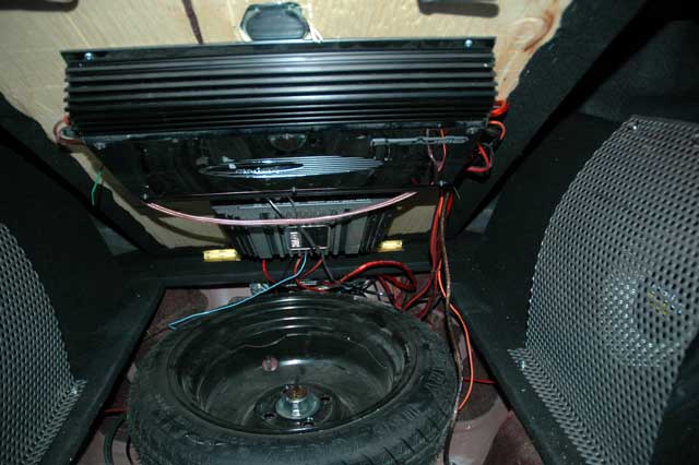

Makes me wish i had power tools to work with. Any worries about the amp overheating mounted like that?

Lighting looks like my trunk, but looks like you used LED's instead of CCFL's
Looks like it bumps.

lol is that chicken mesh ?
Old May 7, 2007
hvc's Avatar
hvc
Joined: Aug 2006
Posts: 232
From: Toronto
hvc is an unknown quantity at this point
Re: Just finished my custom trunk less than 150$
if you read the OP, it's perforated steel. a bit different than chicken mesh.
Looks nice. I'd like to see some before pictures though.

Thanks guys. No i'm not really worried about the amp overheating, before it was sandwitched between the box and the back seats, I don't really see it being any worse.. and it's not chicken mesh. as to the DIY, i know, i should have, but I didn't even think about it until the sub boxes were finished and I had started felting them, by then it was almost too late. but I could provide a set of prints and a walk-through. I'll work on it. The construction was pretty simple, all you need is pretty much a table saw, a jig saw and a nail gun. Also the boxes should be almost exactly 1 cubic foot of airspace.

That looks good man. Nice way on making your own sub guards too.
Do the subs sound different firing sideways like that vs. front or rear?

I'm not really sure, it does sound a little different than before, slightly more quiet, but I did go from a ported enclosure to a sealed one, I'm pretty sure that is where my difference in sound is coming from. Good news though, I have a buddy who wants one of these setups, so I may be building another in the next few weeks, I will do up a DIY then.

Yeah I would have some concerns about cancellation with the subs firing towards each other in that way. It's always so tough to know for sure though when you're also changing enclosure type.
Maybe if you do this car and your buddy only wants one 12" or something you do the sub on one side and the amp across from it. Then compare the systems and see what you prefer? Just a thought.
Very clean though, props.

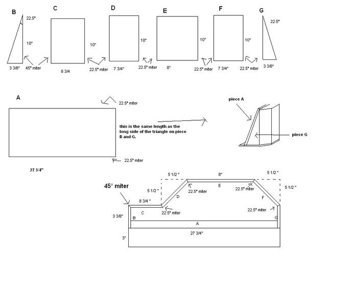

schematics for the boxes would be awesome

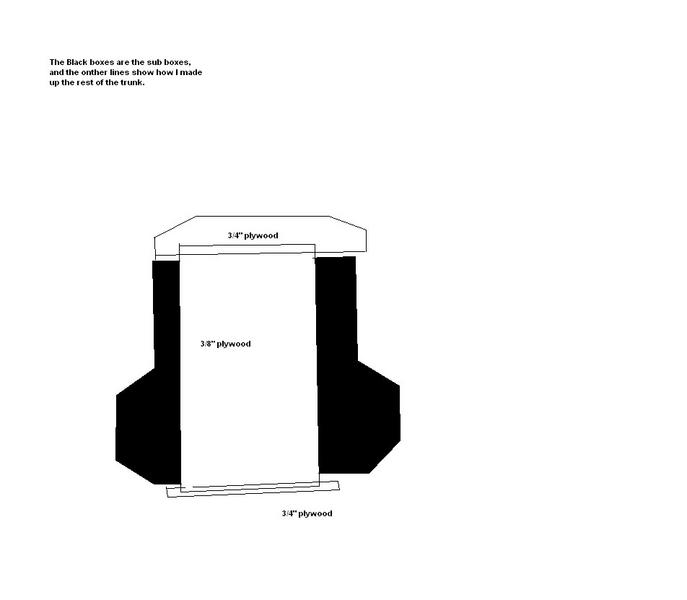

Here are some quick drawings and dimensions of the boxes. I'm not sure how big the top is, because I just nailed it on then trimmed it afterwards with a router. also I would like to encourage you guys to use either lots of wood glue, or silicone to help seal all your joints. if the joints don't quite match up, it's OK, just whip up some bondo, and sand it how you want it. here are the pics.
Before you start, it is probably also a good idea to try a cardboard cutout first, to see if it will fit.

Great job man! personally not a big fan of the bent grill thing.... looks like you put so much time and effort into it all and gave up on the part that people see!
Sick amp placement and awesome sub boxes btw.

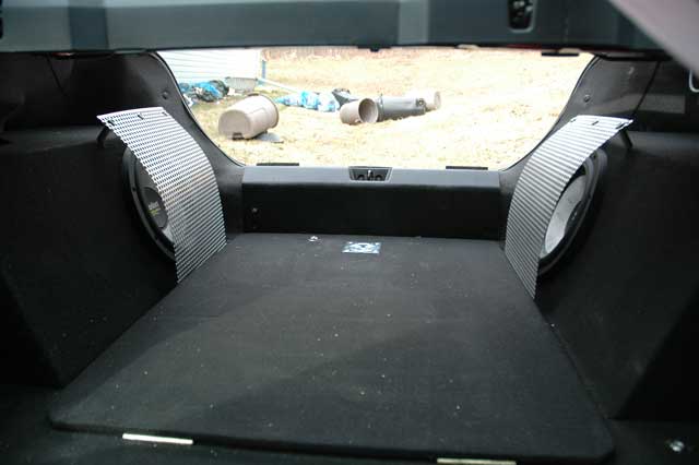

here are a few more pics.
you can kind of see where i laid felt over the wiring right behind the back seats in this one ^^

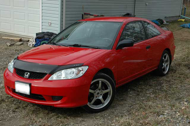

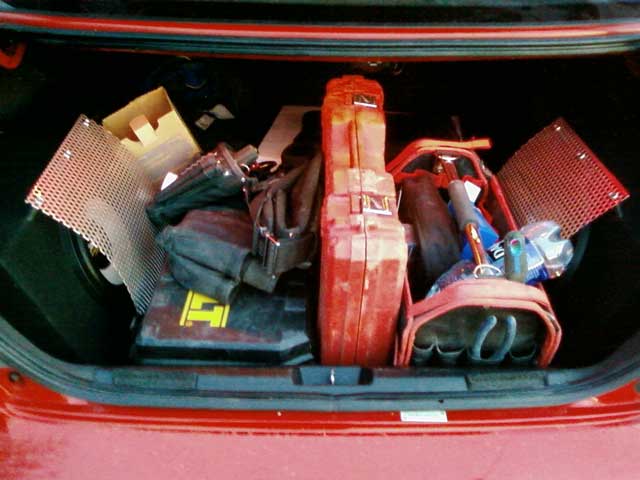

Just got New rims + tires today
i like my grills. this is why vv

nice. what rims and tires and how much for each?

they are the Core racing "hype" 17x7 and a set of cheap federal tires to fit. got em at Kal Tire for 1000$ set.

Brilliant!!!
Now it all makes sense, thats an awesome idea!

if you have a table saw, it's pretty easy. if not: good luck to you.
I found it fairly quick. this is the first time i have built anything like this.
I spent more time designing the box than I did building it, you guys should have no trouble. The felt went on very easily also (the back looks like $%#@) but that doesn't really matter. Just start at the top and work your way down the front.
!!you need to cut out the hole for the sub before you construct the box!!

The way you're emphasizing this makes me wonder if you learned from experience??
