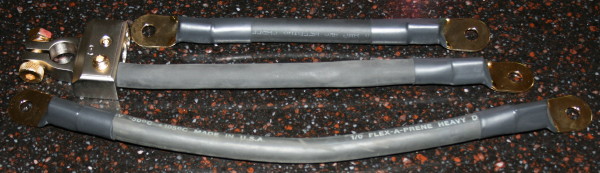

Originally Posted by _unclejuice
still waiting on pics.
ask and you shall receive. this is all 1/0 cable with gold terminals. here's my "Big-3" ground kit.

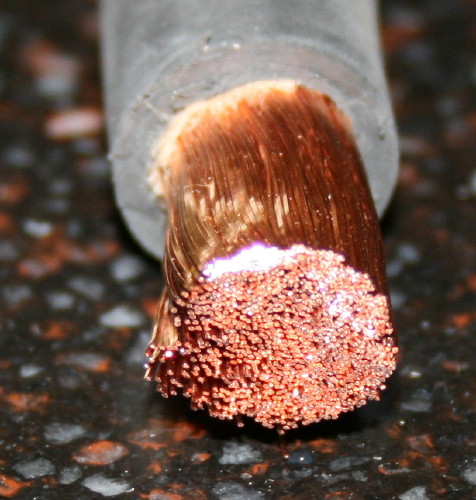

here's a close up of just the wire showing the small strands.

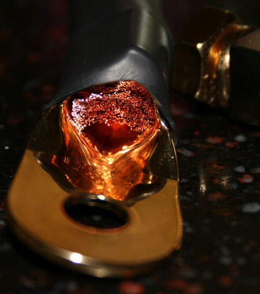

and here's a closeup of one of the terminals.
