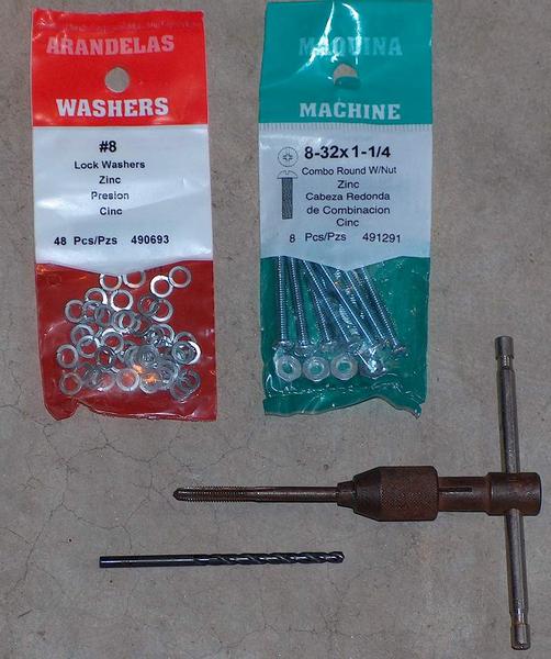

Here's the tap, drill bit, screws and washers you can pick up at Lowe's.

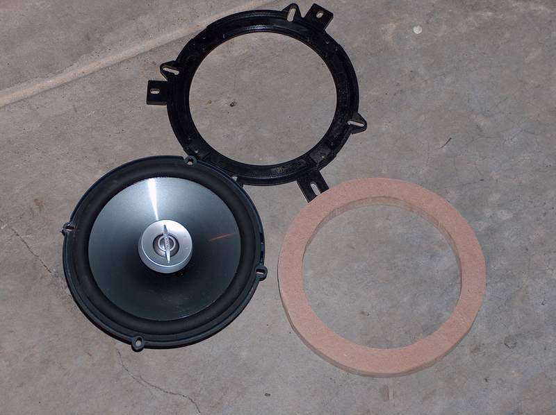

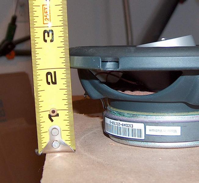

As you can see here, you've only got about 1.75" of clearance between the top of the door panel and the window. also, the width of the opening is ~4.125" so keep that in mind when picking out speakers. especially if you want components. they tend to have very large magnets.
If your speakers are less than that, then you're good. Go head and mount them. My speakers were right at 2", so I needed a spacer.

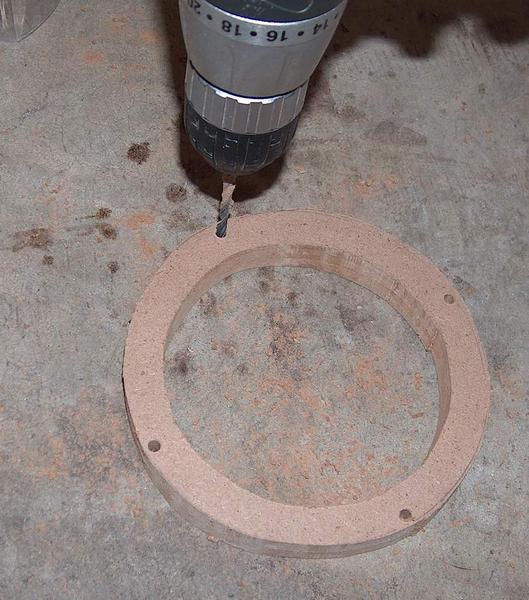

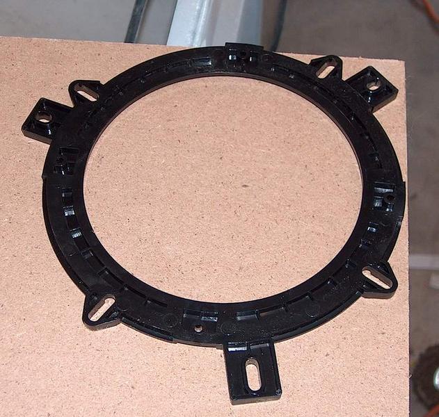

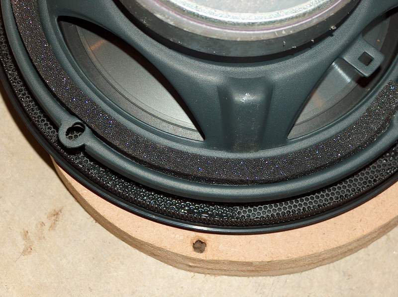

A 0.5" spacer would have done the trick, but I had some .75" MDF laying around so I used that for mine. You can use whatever you want to make your spacer. Start by tracing the adapter ring (or the speaker if you don't have one) as a template.

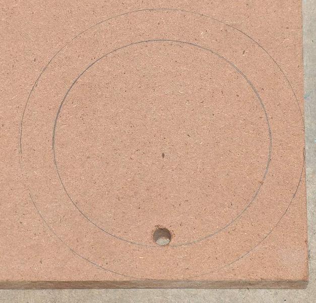

Drill a 3/8" hole in the middle ring so you can get the jigsaw blade in there.
Cut out the spacer and repeat for a second one.
Test fit the spacer on the speaker and ensure it fits. Mark the locations of the 4 mounting holes of the speaker.
Drill the mount holes with a 3/16" drill. This hole is big enough to let the 8-32 screws pass through freely, which is what we want. Again, repeat for the other spacer.
My speakers came with foam, so I installed it on the back of the speakers. I doubt it will help at all, but I put it on anyway.

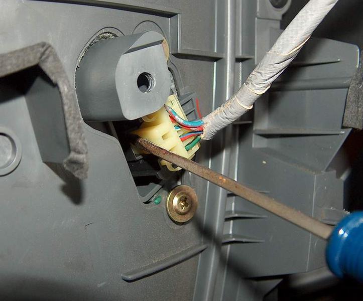

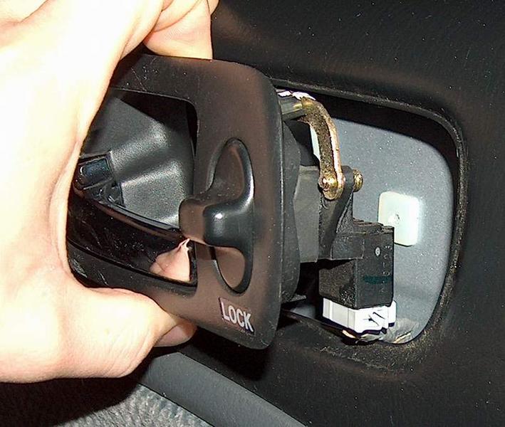

Pull out assembly as shown and remove electrical connector.

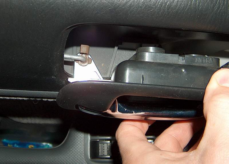

In order to remove the assembly, you'll have to remove the door opener rod. Rotate the plastic connector 90 degrees and lift the rod straight up. Compare the pics to see the connector.
Locked
Unlocked

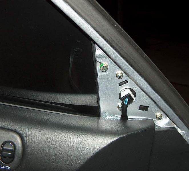

Remove Sail Panel.

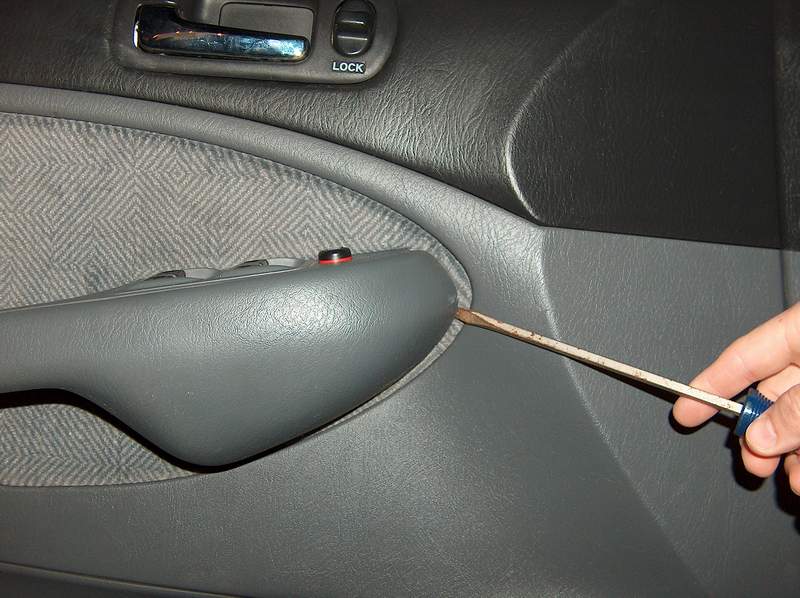

Insert screwdriver as shown and gently pry off the cover for the door handle.

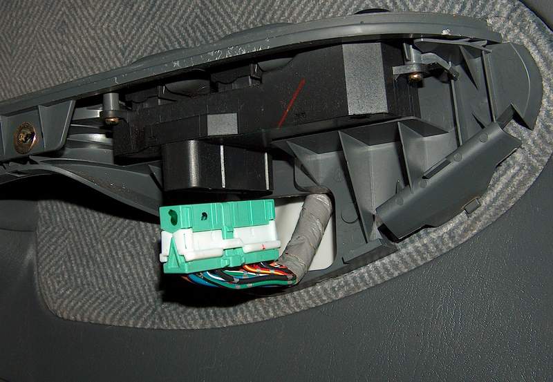

Remove power window connector if applicable

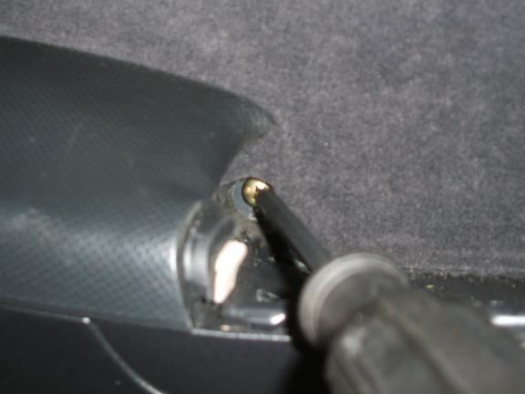

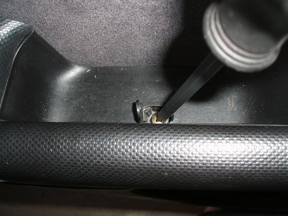

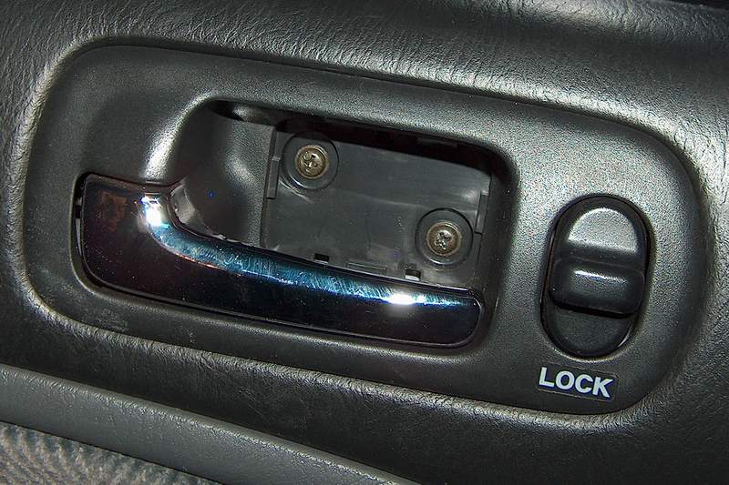

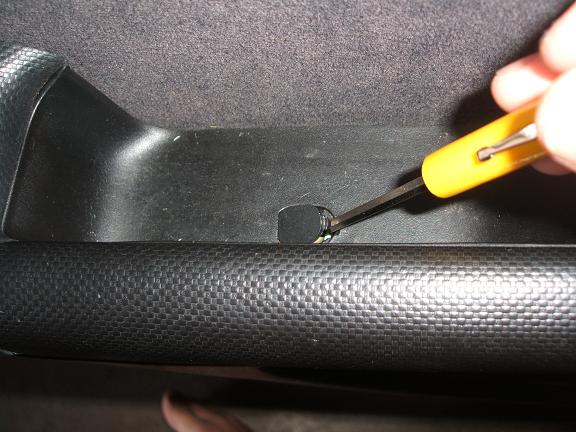

pry up the screw cover inside the handle.
remove the phillips screw.

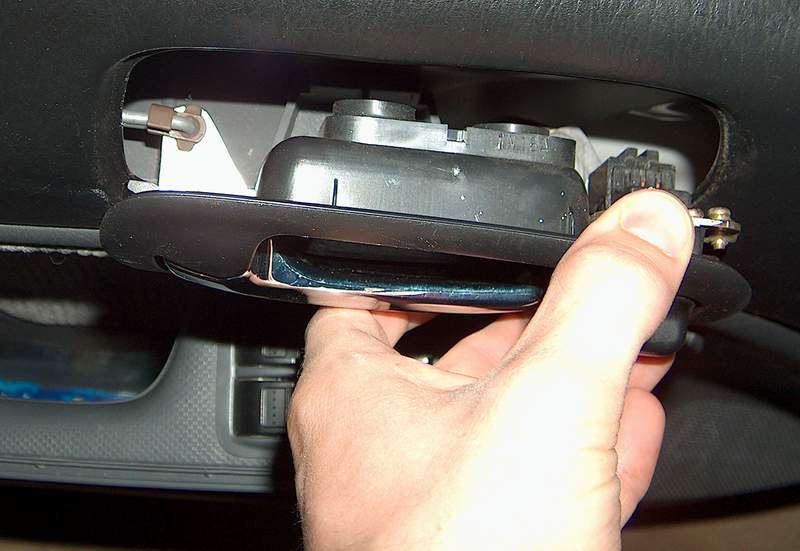

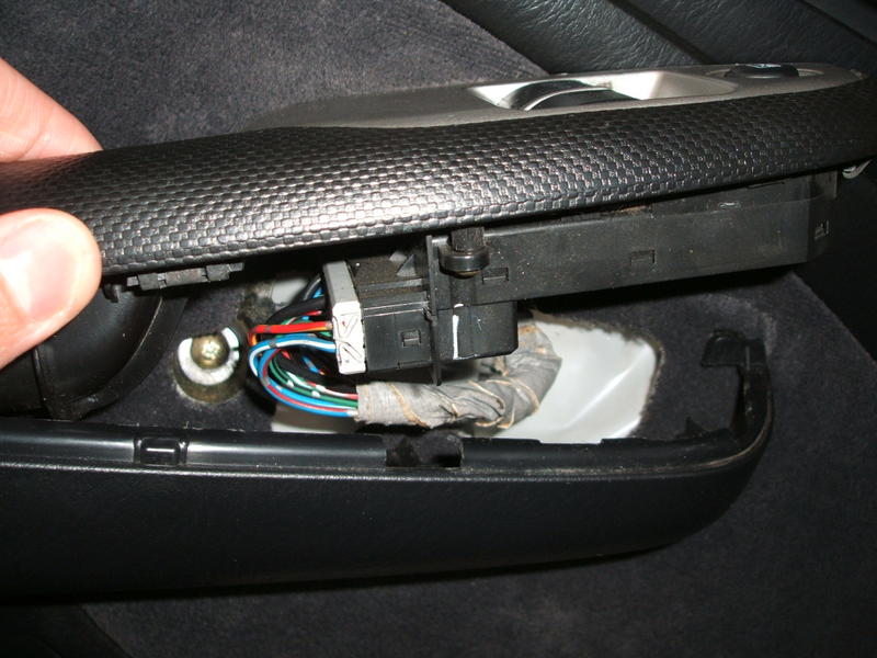

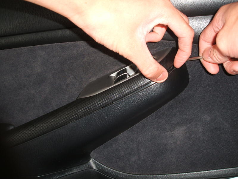

start from the front and pry up the door handle cover until you can slip a finger inside to pull off the panel.
Disconnect the power window connector and set the cover aside

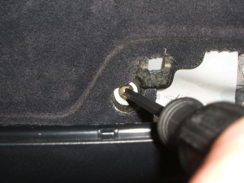

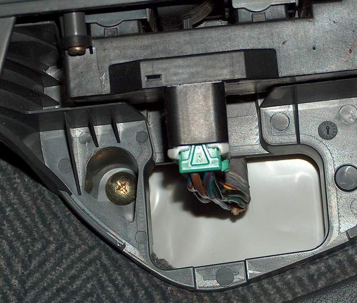

Now remove the two phillips screws:
front...
back...

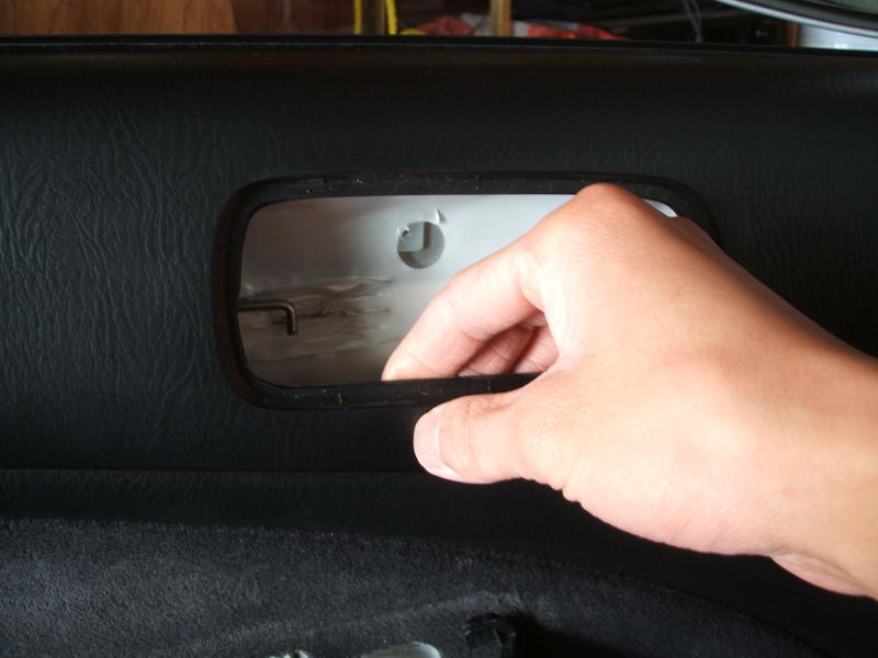

Then stick your hand inside the door handle opening and pull towards you to pop out one of the clips.
The rest of the instructions are the same as the sedan (pry up around the edge of the door panel to pop off the white clips)

Insert screwdriver as shown here or anywhere around the door panel edge and pry up just enough to get your fingers behind the panel. There should be around 5-6 fasteners that will pop off. The panel the slides straight up out of the window channel.

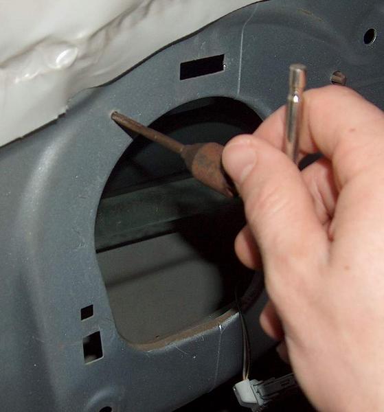

To remove the stock speakers without damaging them, insert the long skinny screwdriver into the top and press down to release the clip.
Wiggle the speaker back and forth while pulling up to release the bottom clips. then admire your massive paper driver! Remove the factory connector

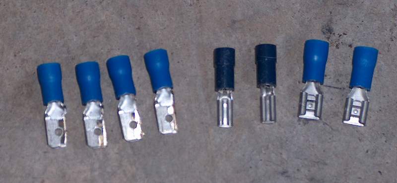

So I didn't have to cut off the factory connector and could reinstall the OEM speakers later if desired, I opted to make my own adapter harness. I only had the larger spade connectors on hand, so I cut them to make them fit. See pic for comparison. If you can get the medium size male's, then you'll be good.
Here's all the connectors you'll need.
Cut the 1ft wire in half, strip the ends and crimp the terminals on to make the 2 harnesses.

Hope you dont mind me adding this electric130. You can do whatever you want with it, change wording, move it etc. I tried to follow the same format you used and loaded the pics as attachments.
Heres a continuation of the panel removal process for the COUPES
The steps are the same up to the removal of the sail panel.
front...
back...

anyone know how deep of speakers u can put in before the door pan wont fit properply
Old Jan 27, 2008
electric130's Avatar
iTrader: (44)
Joined: Aug 2006
Posts: 2,978
Likes: 4
From: Charlotte
Re: ~~~DIY Front Door Speaker Install Coupe and Sedan~~~
it really depends on the speaker. mainly how tall the speaker is from the back of the frame where it would bolt to the door or a spacer and the top of the front. usually, that's the foam around the edge. i've found that most speakers fit on the front side with a 3/4" spacer ring. with a 1" spacer, a lot of people have had to trim the door panels. so there's really no clear answer to this. i gues if someone was willing to drill a big hole in their door panel and take some measurements, we could clear this up, but untill then, we'll have to go on a case by case basis.
I have infinity kappa 63.7i in my front doors with 1 inch spacers. The mounting depth of the speaker is 2 3/16. According to Crutchfield, this speaker doesn't fit, but it work for me with a 1 inch spacer.
What speakers are you trying to put in??

WTF?! On my ex coupe, I had 10mm bolts where theses screws where at. Is that right?
front...
back...
Old Jan 30, 2008
can't help you on the coupe. that looks completely different than the sedan. shouldn't matter though, screws or bolts. probably not the original parts.
