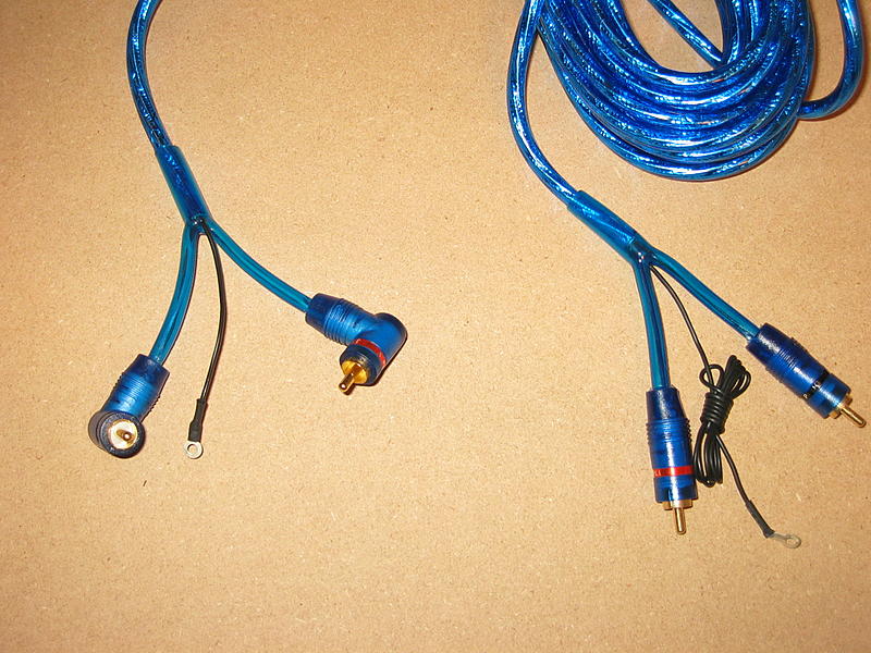

The ground wire attached to the RCA snapped, so I went to the store where I bought the kit and exchanged for a new one.
Question:
Why would my RCA cable have grounds attached to both ends? I have never seen them that way.!
Will I create a ground loop if I use those grounds in addition to grounding the other equipments?
I mean, I'm grounding the deck and the amp already right? so why ground the RCA?

if youre talking about the black plug on each end of the rcas, thats the left audio signal. the red is the right audio signal. anyway, grab a monoblock amp for the sub and use your 4 channel for the doors.

Actually I know about the left/right channel of RCAs. What I"m talking about is this weird little ground cable protruding between the black/red cables that actually has a ring terminal. I'll try to take picture when I get home later.
It's not on any other RCA I've seen.

if its just a wire exposed on both ends, i would ignore it. only think i could think of is it grounds out road noise???

It's a ground wire, I don't think I've ever had to hook one up in a car before. That's usually a home audio thing, between your pre-amp and amplifier for example.

i havent had any rca's with one. never even seen it in a kit.
i have seen that with some types of rca's before..i used it as remote wire for the amp ..cuz its attached and going to the same place..lol

I haven't seen one before too, here it is. One of the ground wire chaffed open so I had to go back to the store to ask for a new one.
Thanks christmaspie.
Should I use electrical tape over the ring terminal if I'm not going to use it, to avoid unnecessary grounding?
Absolutely, and I don't like to use that wire as remote turn on myself. I run everything (speaker, power, remote turn on) on the opposite side of the RCAs when doing full range speakers.
