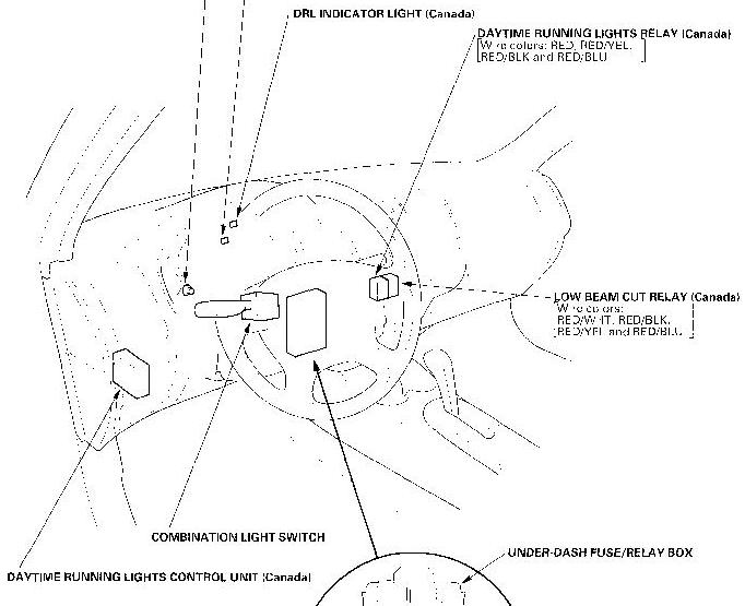

Originally Posted by christmaspie
I show the relay in the center of the dash almost behind and to the left of the left side of the glove box cavity.
from above

Originally Posted by Keigo
what do u mean by center of the dash?
Check attached pic, it's not the best but it should get the point across.
was told that the daytime running light relay under the dashboard by the drivers side above the clutch????
Hmm, sounds like more like the DRL control module but I really don't know to be honest.

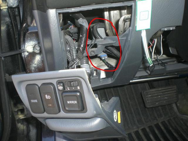

Key Keigo,
I just noticed you have heated mirrors. That is cool. Also since you have the DRL switch where the U.S. moon roof switch is. Where is the Canadaian model moon roof switch?
Old Jun 26, 2007
Rep Power: 812
Re: DRL electrical woes ... How screwed am I?
drl switch? wheres that. i didnt think stock cars came with em its automatic turn on with ignition.
Old Jun 26, 2007
Alpha 5's Avatar
Joined: Dec 2006
Posts: 3,091
From: We are Anonymous!
Rep Power: 329
It might actualy be the fogs but I thought that the fog switch was in the center console in front of the shifter. Regardless of what it is where would the Moon roof switch go? It would seem kinda silly to put it in the center.
It is the first link he posted.
Here it is

Hey folks,
I am going to give this a try. One Q: How do I pull the panel holding the switches that's covering the DRL module? Don't want to break anything with excessive force.
Thanks!
Old Mar 19, 2009
Rep Power: 812
you mean the one with cruise button? open the coin tray and remove the one screw on top. then the whole piece just yanks out.
