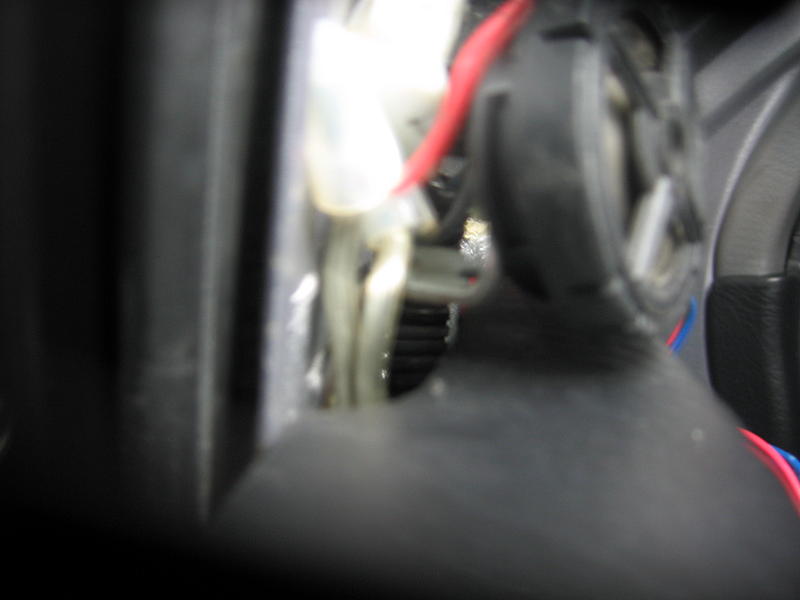

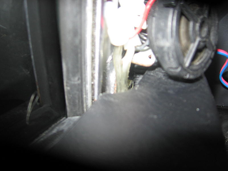

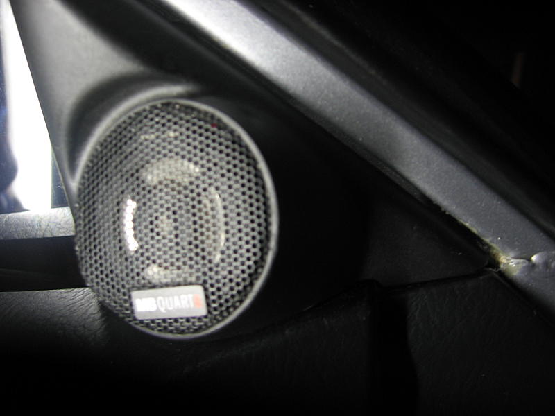

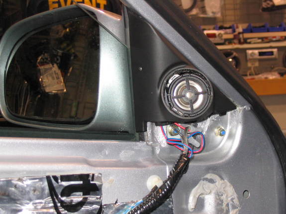

You should be able to fit it no problem. It all depends on the way you mount it. I used backstrap bent up a little bit attached to one of the power mirror nuts. That way you can sort of make the tweeter float wherever you want it to. I did need to take a die grinder to quite a bit of the plastic inside the sail as the factory tweeter is rather small. I'll take a picture tomorrow with the sails off so you can get an idea of one way to mount them. This pic might show you what I mean for now.
Alright, screw it. I went out and took a couple of pictures. It took a lot of trial and error to get the bend on the backstrap just the way I wanted it. If you're willing to spend the time you can mount just about any tweeter (less than ~ 1 inch) in these factory locations.

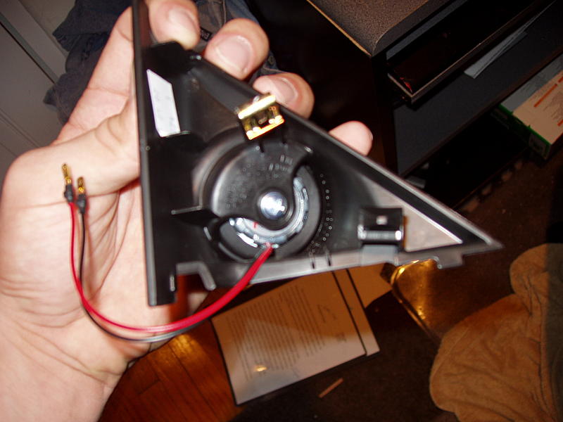

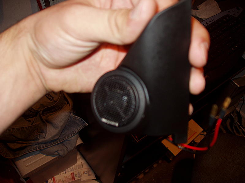

I was gettin worried that my tweeters wouldnt fit like you guys said so i went to the body shop and grabbed my sail panels. These fit perfect and screw into the sail itself. I dont know if you have different panels or what but there is no problem here

I measured these tweeters at 1.5 inches
