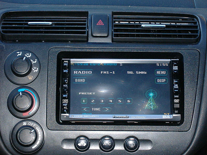

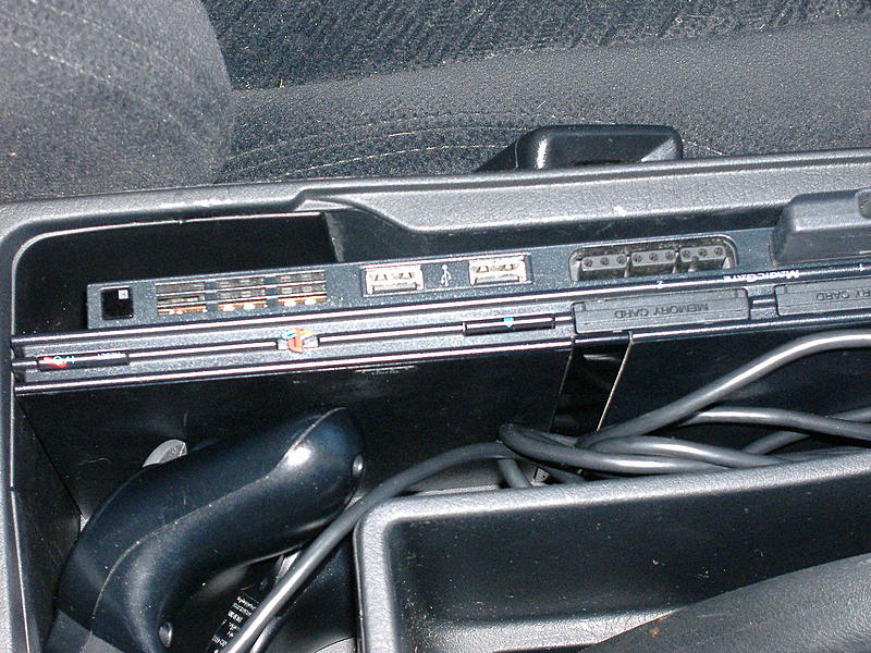

Because so many people also think the double din wont fit and dont think i wanted to post some pics of it. I got the double din installation kit off ebay for like $20 and cut the middle bar out.
yea, i was gonna say. ive done just as many double dins as single dins into 7thgens over the years. a metra 7865 with the middle bar cut out works quite well.
