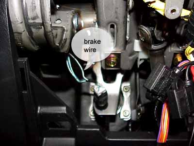

I don't know if anyone wants this info or if we're all just driving around watching South Park but here you go.
Foot Brake: white/black (+) @ brake pedal switch (picture below)
Parking Brake: green/orange (-) @ base of parking brake
