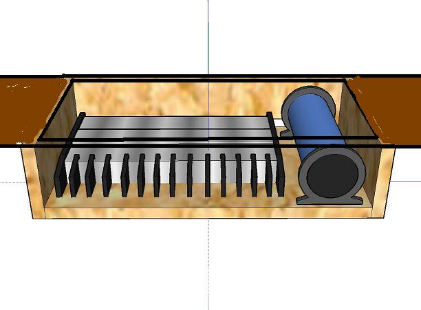

Here's something I did while practicing the use of SketchUp, a program diskreet recommended. I was just seeing what I could do with the program so...
Anyways, I think I put the speaker on the wrong side, I know the sizes are all wrong and the connections on the back sux0rz... They are made for like... 2" cables
Here goes nothing...

that looks really good ramcosca. Better than almost all of the crap I have done in that program!

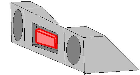

A friend suggested me building something like this. What do you think? I like it.

the depends on the amp your going to use... my amp would suck because the inputs are on one side and the outputs and power cables are on another
i like your sub choice
