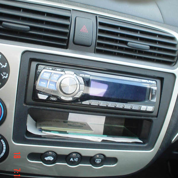

i got a 9835, thats how it worked for me.

I never seen anything like that, even I have the dimmer wire connected and mine works out fine. The dimmer **** has NOTHING to do with aftermarket head unit. The head unit will be less illuminated but still able to see clearly at night. No black out.
If it's about your gauges, check your illumination setting for headlight OFF mode. Turn it all the way clockwise unitl you hear the sound telling you the max. You can NEVER set the headlight ON mode brighter than what you set in OFF mode....
