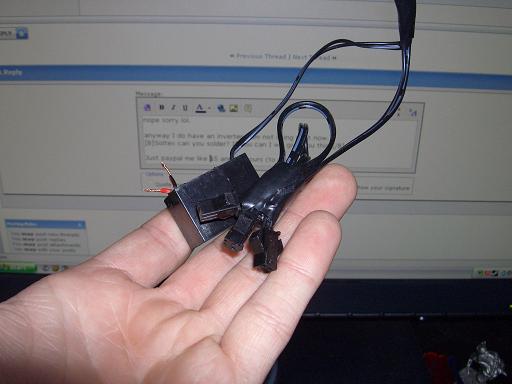

anyway I do have an inverter I am not using right now.
Soltex can you solder? If you can I will give you this:
Just paypal me like $7 to diskreet(at)gmail.com and its yours (to cover shipping).
Its a mini inverter. Just needs wires soldered to it. Its tiny though.

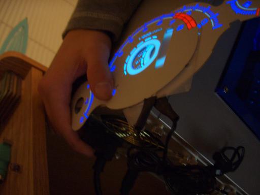

Me testing on external power connector on computer:
Just plug the + and - right to your gauge cluster wires.
here is the wiring for the cluster:
[BLUE connecter]
Red/Black: Supplies 12V+ for dash backlights
Red: Supplies switched ground for dash lights
Just hook 'em up to those 2 wires. test it first (cluster must be plugged in for this to work) and if its right solder it up.
If you want it ill send it out tomorrow, just PM me your address. heck if you dont have paypal ill just send it to you anyway.
