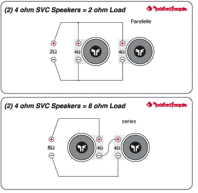

here is series and paralelle. you should put it in series. But you will only have half the power your amp can deliver, so i'd get a mono amp (then you would push it to it's potential) or get 2 DVC 4ohm subs and then you'll be able to hook them up in a 4ohm load.

which is series and which is paralle? I don't understand...
Old Jul 24, 2005
Blahman240's Avatar
Touch it... He won't bite, He'll just come at you pretty quick.
Joined: Apr 2005
Posts: 1,278
From: Wilkes-Barre, Pa
Blahman240 is on a distinguished road
oh... I see.
