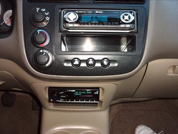

I just aquired my White 02 Civic LX a couple weeks ago. (no pics since it's completely stock at this point). After checking out this forum I decided to go with the Sirius Starmate Satellite receiver instead of wasting time with a factory CD player...and I couldn't be more happy. Anyone who has the Starmate knows the one downside is that it's not exactly designed for easy permanant mounting.
I figured it might help a few of you to see how I mounted mine using some crap I had laying around and parts from the suction cup mount that comes with the starmate.
1. Finished Install Pics (to see if it's worth the trouble)

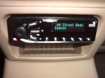

2. Top View

I hope this makes some sense, and that the pictures explain more clearly what the words do not.
It took about an hour and the finished mounting lets me remove the starmate easily for bringing in the house, and is rock solid when driving about.
