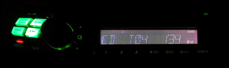

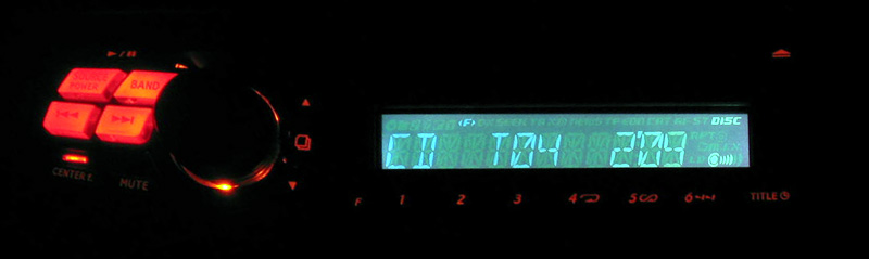

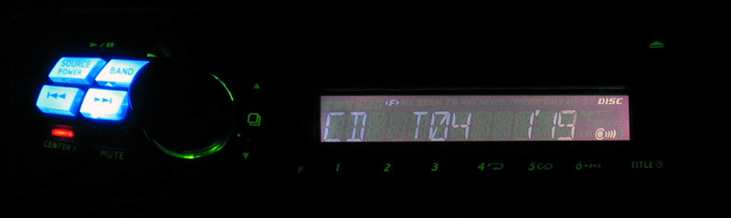

i still have to figure out this headunit.

you made the install seem harder than it was, with your questions. that's good that you got it working though, first headunit install? i'd be a bit scared to fry a headunit, so i guess its only natural to ask.
what headunit is that? which alpine model?
