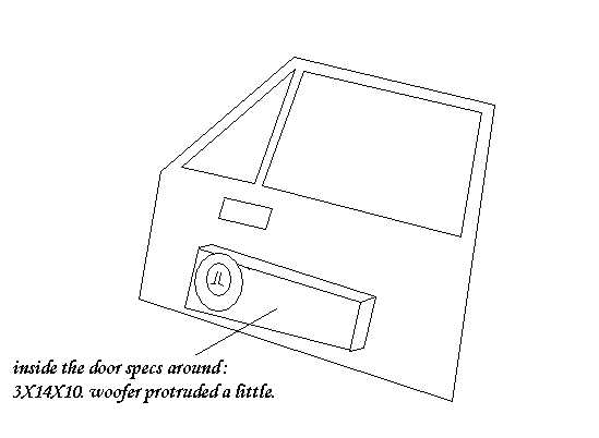

I know a JL freak that put 8's in the doors with an enclosure.
Thought about it. Wasn't sure how big the enclosure would have to be. It'd be a hell of a bubble. I still maybe willing to do it. Don't suppose you got pics of the Freak's doors?
Naw, this guy was my so called competition he had a custom orange s-10 with three 18"jl's on 2250 ppi and 4channel ppi for all his mids, but from what I had seen he did was similar to this: So all you seen was the woofer in a flushed fiberglass enclosure.

Hmmm, You've got me thinking. I'm gonna look inside those doors this weekend. THanks.

No prob, most models have a ton of space. Hope you do it. love too see pics.
