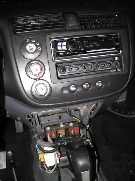

should I use fiberglassing for the custom headunit area?
Old Apr 5, 2005
thejdog's Avatar
Posts: 92
From: Huntington Beach, CA
thejdog is an unknown quantity at this point
Or body filler? I wanna do a small project, well smaller than making a subwoofer enclosure as my first custom project, well kinda custom. Last night I redid my radio harness in my dash to fit my subwoofer processor/eq.
What would you recommend for fill the gaps below and above?
Thanks.

Personally, I might use abs plastic - I'd have to see it in person. But if you are set on fiberglass or bondo, I'd recommend the basic structure to be made out of bodoglass, a special blend of the two which adheres abnormally well to plastics. Then fine tune with regular body filler.

for minimal labor and headache, move that processor up to the trim or down at the trim and fiberglass the openning. filling the top and bottom will increase the difficulty of precision, so i suggest on filling just one end (top or bottom).
if thats in mind, to get start w/ FG....
fleece the opening from the the other side of the trim and resin it. then lay a layer or two and finally bondo to finish it off.

^^^ agreed, after you bondo the center section you should paint it to match the outside of the car rather than trying to match the rest of the dash.

So if I was to FG it, wouldn't I take out the processor and just FB the whole opening and then make a new opening for just the processor? Or just bondo it?

Make a cardboard template that the proc will fit into. Glue it inplace on the console. THen, spread bondo glass around and in the seems with a squigy spreader. THen go over with bondo. Then poly filler. THen prime then paint

Well I went and bought a new dashkit, so I could play around with it, and not have to take out the whole stereo again, like I did last night.
I used my dremel to cut a better area so it fits all the way to the front, since it's the same width as my headunit, and the bottom console is a bit slimmer. I just did one round of fiber resin. I'll add another coat of it, and some bondo glass, sand it down a bit, add a bit of the bondo to the back of the face area, so that it supports it better. Then I'll figure out a good color, that matches with my dash a bit better, never liked the front of the dashkit prior because it was kinda textured, when the actual dash isn't.
Thanks for all the help guys, I'll post some pics when it's done and ready for paint, which with the time that I have, might be a few days, while in and out of work! Just waiting for this stuff to dry sucks, cuz you come to a stop point!

Thanks for the tips. I got the resin and fiber glass mat on right now. Here's a pic. Does it look right so far?
This is the second layer of the resin so far. How many would you recommend?
Thanks.

what the hell is that? why isnt the mat trimmed?

Well from what I know, when you first put the mat on, you trim it with a few inches on each side. the mat was 9 sq ft. the smallest I could find haha

you want to trim and lay the glass to its surface. youll gonna have a hard time trimming and sanding that down later, since the hardened glass is sticking out.

Hmmm, dremel it?? Would that work?

youll know when you get there. dremel works but leaves uneven edges and its not fun to sand glass.

you should try using a grinder to get rid of all that extra glass you can get pritty close and have smooth lines, then switch over to sand paper
