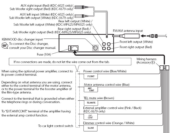

Dude, its your wiring. On the back of the deck there is a Blue wire and a blue/white wire. Hook your remote lead going to the amp the blue/white not the blue.
Later
do u have this radio?
my point is... if the amp/subs work when the tuner is on radio. its telling me that the amp is actually powering up and it should work period..i dont c anything that says "connect these wires with these other wires so the amp and subs can work during cd playback" .or am i wrong?...

found the problem...
the solid blue wire that comes out my radio is for a power antena...
the blue and white wire is the wire for the amp.....
remote wire was wrong....

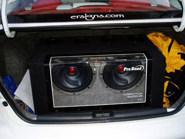

here are the pics so far
i dont have one of the amp yet but i promise ill get some when its compleate..
sorry for the mess in the back cant wait for HIN its gonna look sooooo good and its sounds reeeeeeeeeaally nice...
