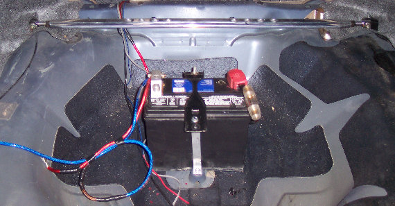

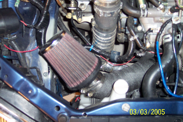

i'm tryin to relocate my battery to the trunk... everything's connected right but it won't start... it seems like it doesn't have enought power to start up the engine... do i need a bigger and higher amperage battery? why is it not starting? help please... thanks!!!
it looks ghetto... but that's all i can afford for now... battery ain't going anywhere i was bolted down tight... but starting is pretty weak... i think i'm gonna get me one of those batteries from walmart with 650amp for 60 bucks... what you guys think?
subs and amp still have to go back in the trunk... my intake had a lot of room now than it was before... i forgot to take a picture of it... i'll post it tomorrow on another thread

i just checked the voltage on the battery and it's on 11.5V... need helppp

The car should still start with 11.5V. What guage wire did you use to relocate the battery? You will probably need bigger wire (lower gauge) because of the distance.

thanks for the help guys i got it workin... i jump charge it for about 20 mins... but as far as amp on the batteries... i know that our 7thgens are equipped with about 200amp battery, if I get a bigger battery that has about 650amps will that mess up my car? thanks for the info...

i have very weak starting after i relocated the battery in my trunk... it starts.. but barely... i guess i need to buy me another one with higher amps and connect them on a series... optima batteries are great but expensive... any other batteries out there that are similar to Optima???

how long of length are the wirings? my guess is if its longer, its gonna take longer for it to spark thruout the cables.
when choosing a battery, first think of what your gonna do with it and your plans for it. optima yellow is a great choice all around but there could be batteries that can do you no good for what you paid.

is that 8 gauge wiring?
Don't most battery relocation kits come with like 4/2/or 0 gauge wire?

yes it is 8gauge... 2 or 0 would probably see a difference but not 4... anybody out there that had their battery relocated? please give me some info... so i can clear this up... thanks!
ok i will get a bigger wire asap for POS... but the ground will stay the same... 8gauge... is ground as crucial as the POS wire?

Did you relocate your spare to under your hood?
Are you running a 4g or larger ground and power wire to your starter? Where are you grounding your bat?

how much did you spend doing this on your own?
http://store.summitracing.com/defaul...0&autoview=sku
$42.95
It also uses 2 gauge wiring, which i think would help your starting weakness.

its definitely the 8 gage. I was running 0/1 when I tried this, stock battery in the back, no battery up front, and my car would need to crank over a couple extra times before it turned over.
youll just have to live with it if you want to keep this. long wire, voltage drop, slower start. you want a better start, get a higher voltage closer to the starter.
may I ask why you want the battery in the back? the weight cant possibly do you any performance good compared to loading down your drive wheels....

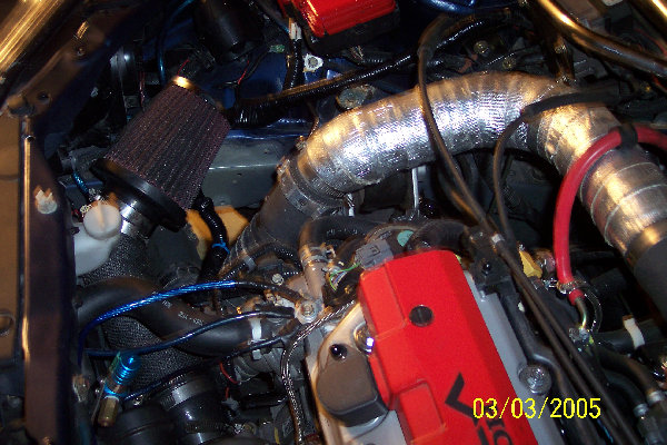

to answer you question... here's why...
from:
to:
it's easier for me to clean the filter, and it'll be a little higher from the ground... it's been raining alot here in vegas, and the filter used to be in the back, and down next to the clutch cable... sometimes i can feel my car buggin down when i hit a puddle of water... and also somebody did a DIY about the acura air box CAI conversion, i might do that, soon aswell... summer's coming up... the CAI box would help alot...

I already ordered the 2gauge wire... that should help a little bit... and i'm getting the OPTIMA D31D OR D31T... <<< that should get me crankin

keep the voltage high, and that will keep your starts in relative order.
wouldnt it be cool to be able to run how the hybrids do, and have no cranking at all? quiet on, quiet off.....
if you can, I would put that battery as far forward as you humanly can. keep it in front of or on top of your rear wheels, and it should help out handling a bit. I assume you have an upper stabilizer bar? might be a good place to strap the battery box you will eventually have....
