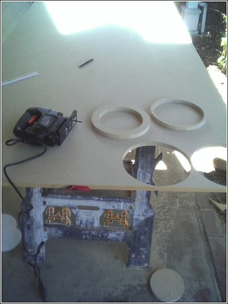

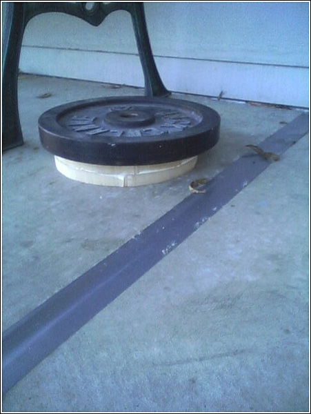

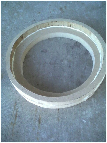

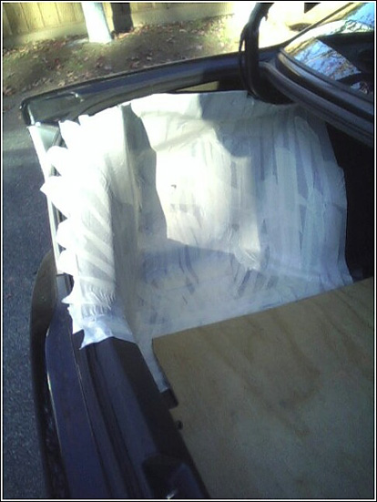

So far i have cut out the speaker rings and taped of the trunk. didn't have enough light to start fiberglass, but going to start fresh tomorrow. I love christmas break! so many things to do, so little time.

its easier to get good adhesion between the baffle and the cloth if you sandwich it between the trim ring and the mounting ring. then there are lots of ways to smooth out the steo thats there and relaly make it look rather nice.
to be 100% sure the box doesnt warp out of shape, you cna use kitty hair as reinforcement, since all fiberglass will warp. but if you dont stretch your cloth ubertight and do the top layer shortly after finishing the backplate, it shouldnt warp too badly.
once its stretched I dont think it will post construciton warp. if you carpet, for sure it wont.
um, look closely at the other side panel and how it folds under the rubber grommet around the trunk lid. the best design will fold the same way for a seamless design., I dont believe that will work well after carpeting. you might be abl eo tjsut trim the carpet so only the carpet folds under that. But regardless, its something that must be planned for, to look seamless.
good luck, it looks veyr well done so far, im sure the finsihed product will be great!

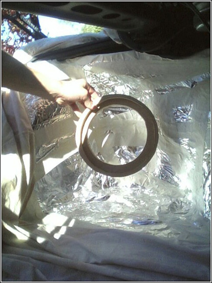

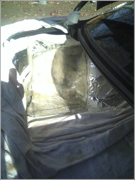

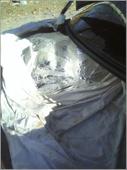

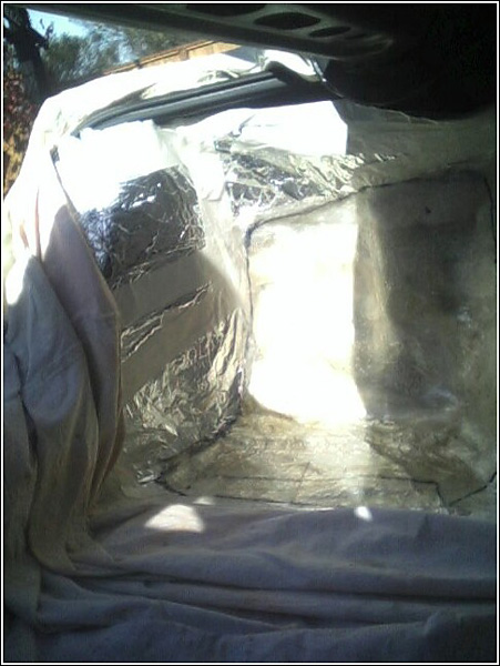

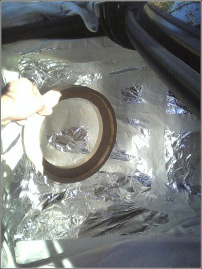

Day 2
Here are some pics of tape and foil, speaker placement and my first layer of FBG(fiberglass).
I found out first hand like most people have said you need more hardener for the resin because they just dont give you enough. Thats going to hold me back a little bit today but i didnt have a whole lort of time to start with. going to play some bball later.
I am working with FBG mat (stuff you can buy at homedepot) and it comes apart easy when you dab the resin on. best way i found to do it is put down a layer of resin where your going to lay the FBG, lay the FBG and cover it wiht resin with a dabbing motion of the brush, but thats also how the mat comes apart easily.

good call with the marker mark on the boundary, to keep track of where you *plan* to cut the backplate.
I didnt realize you werent going all the way up to the trunk edge. thats gonna make the project just absolutely a ton easier, I have to say. All the junk I was rambling on about with kitty hair and warpage is gonna be a moot point.
do you have a solid plan how you are going to have a boundary between the box and the car? as it looks right now, itll have a seam, which is totally cool, but the box and trunk panel will be at right angles. Any ideas on how you will integrate it more to look like a stock addition? or do you plan to just make it look like a bolt on?
(I am actually asking this now because im still trying to get better at this, making installs look factory or classy, rather than custom and aftermarket, and thought you might want to keep it in mind, or more specifically, give ME ideas )

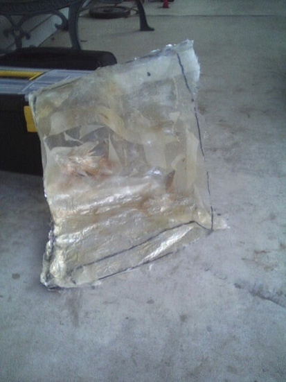

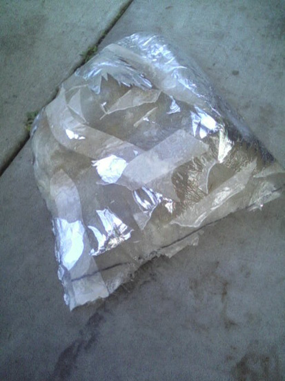

here are some pics of the 1st layer. I pulled the mold out and i'm going to put down some more layers tomorrow. looks good so far, 1st layer is brittle but strong. What do guys think about putting the first half layers of FBG mat and the last half layers of FBG mat?
