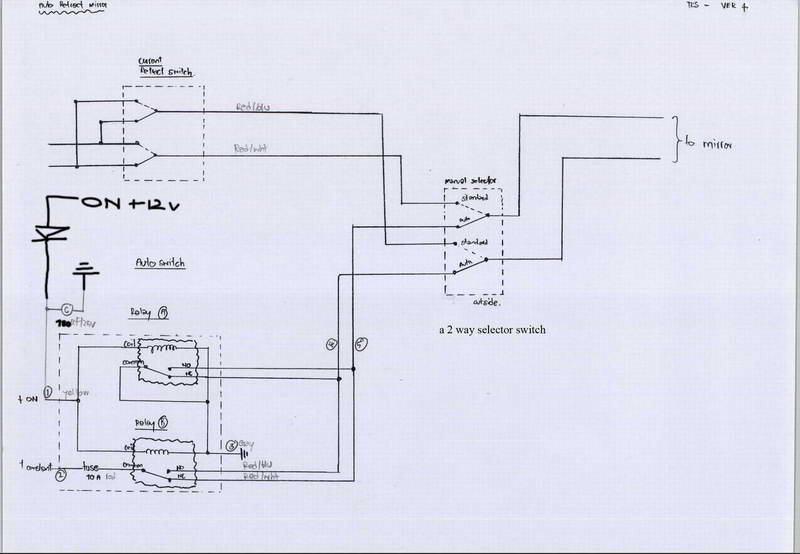

Well, for those who have a retractable mirror, as you know you have to push the button to close and open the mirror. I just got this idea from a Lexus LS 430 which have a auto retract system that close the mirror when you turn off the ignition and open itself when you start your car. So I develop the cirucuit which is easy to construct and work just like the lexus. I have the vdo clip to show but the size is too big to upload. so I will up load the circuit diagram instead. If anyone like to see it I can send it to you via e-mail.

Stuffs you need:
2x 5 pin 12v relay (at least 10 A) which have NC, NO
1x 2 source selection switch like a 2 ON and 1 off switch
1x fuse holder
1x 10A fuse
1x Diaoad anything that can handle at least 12 v and 10 A would do(optional)
1x 100 uf Capacitor (optional)
Wires
Tools need:
Soldering kits
drill
+ screw driver
a scissor or anything you can peal off a wire
Electro tape

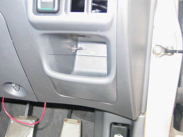

This is the selector switch to select between the Original button and the auto system, I hide it there as I don't want to show but still want easy acess
