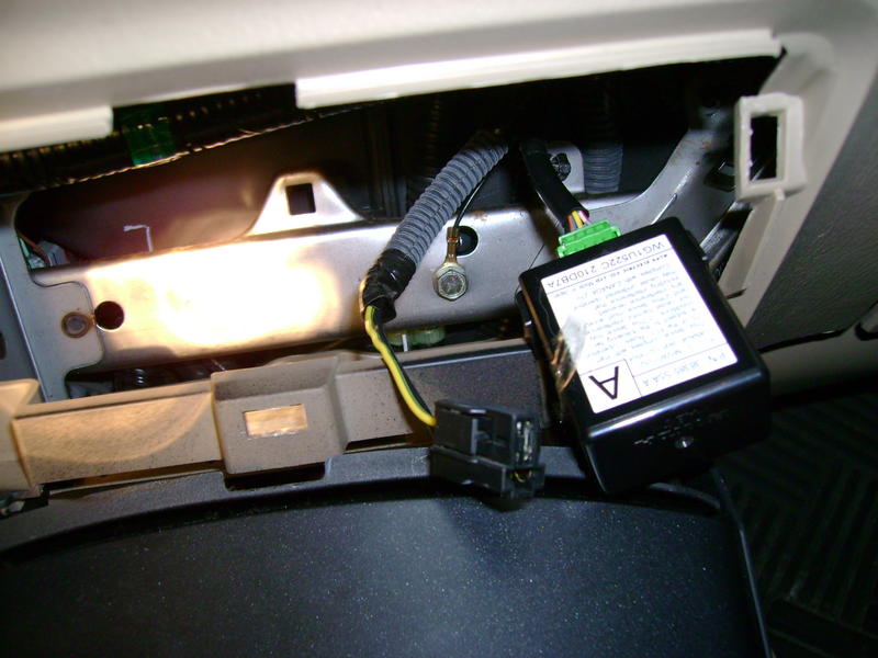

Re: DIY: Head unit install
Got it out! i'm so proud of myself.
now i'm just confused about what kind of adapter/wiring/harness i need to connect to my ipod headphone jack. i tried taking a picture of the back of my stereo. anything look right? do i plug an adapter into the existing port on the left or use the already existing wires on the right?
the second picture is the little black box that says 'honda abs'. the wire on its left is for the cigarette lighter. still can't figure out what it is though.
thanks
im confused here, what are you trying to do?
and are you using your stock deck?
and that little harness for the cigarette lighter is supposed to plug into the back of the cigarette lighter. thats how you get the power to it.
Yaaaaaaaaa, you lost me too. I had you while you were trying to get the stereo out but once you mentioned the iPod you lost me. You can't plug an iPod into a stereo with no inputs bro.
it's just a cd player & radio right now in the stock deck.
i thought there was some sort of input adapter i could buy to connect to the back of my car stereo so that i could play my ipod?
like these: http://www.installer.com/aux/
oh, so you do still have the stock deck. you cant really do anything with that thing.
i wouldnt even bother with any of that man. it looks like you would have to buy both the harness and the bigger unit too.
you can get a really nice aftermarket deck that has an ipod connecting wire coming out of it, right off of ebay for the same as what you would spend doing this whole thing. you also will be able to add rca cables if you want to add a sound system, you can change all your audio settings, etc etc. you can do so much more with it for the same price, it performs way better, and it looks way nicer.
heres an example. this is the exact one i have in my car. its very nice, has a lot of features, and you can change the displays and stuff on it. its black and silver with blue display lighting. it comes with a wire that plugs right in the back and comes out that you plug right into your ipod. you can control your itunes music right on the deck too so you dont have to mess with the small ipod.

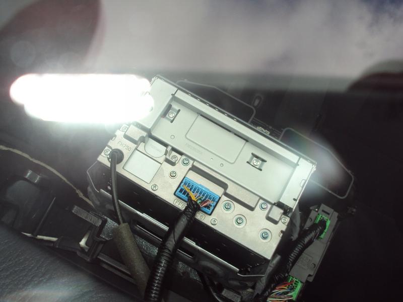

Mega - great job on the pics! I just purchased an '05 civic EX SE coupe (used) yesterday. This radio has the aux jack - convenient, but I hate wires showing...so I wanted to pop the radio out to see the connectors in the back. With your help I was able to get it out in 10 minutes! Thanks again...
Now, back to the issue at hand - finding an adapter unit which will plug into the only connector on the radio but provide an additional connector to run an ipod (nano) such that you can use the radio buttons to control and charge the ipod.
If such an animal exists, I'd be curious to see other's installation ideas.
Nope. The blue connector is the only one. Logjam believes that connector operates the cd changer - but in the SE the changer is integral to the head unit...so I'm not sure. I suppose I could pull the connector and see if the HU still operates.
Assuming it does, I too have seen several versions of an adapter - just wondering if anyone on this board can share some experiences/opinions of hardware they've tried.
Unfortunately, as expected, removing the blue connector renders the HU powerless...also reminded me put the radio code someplace where I could find it easy.
But I thought I recall seeing (somewhere) an adapter that runs between the vehicle harness and the radio...any ideas?
