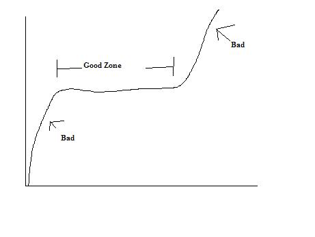

in the case of a motor, it's actually better for it to run at max output all the time, changes in duty cause it more harm. so common assumptions can be wrong. an amplifier is composed of many diodes (they make up transistors, which are the building blocks of amplifiers), which have an unusual response to voltage. they have a wide operating zone where it really doesn't have an effect on the diodes what voltage they see. i attached a crude diagram, you can see what flexibilty you have with diodes. the only big strains on the amplifier could be the power supply, and again, better amps have better power supplys. i'm bored, so i hope you learn something
