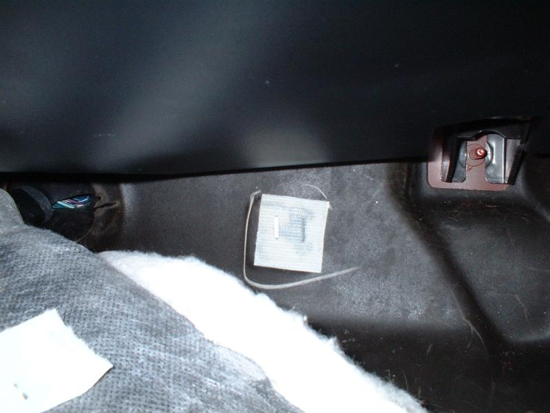

I'm hooking up my amp and sub right now on a 04 Civic coupe. I can't find a space to get the amp power wire through the firewall. Here's a pic of what it looks like under the glove compartment. I took the screw off that metal piece on the right but it doesn't seem to open up. Where should I put my power wire?

look left...pull the black mat up until you see the metal...then you'll se the the plug where you can run the wire

you'll see a whole group of wires....that's the best place. if you look in engine bay on the firewall you'll see all the wires coming out and the black rubber boot. hope this helps.

OK, I'm gonna ground it to a bolt that separates the backseat from the trunk. I looked under the hood but couldn't see a place where a lot of wires were coming through. Is it the thing all the way on the left of the pic where all the wires are going through or do I need to pull the carpet up more to see it? That was the most I could pull it up, the rest of it is under the center console.

I'm pretty sure that group of wires on the left is the same one I ran mine through. I couldn't really tell where I was looking at in the pic.

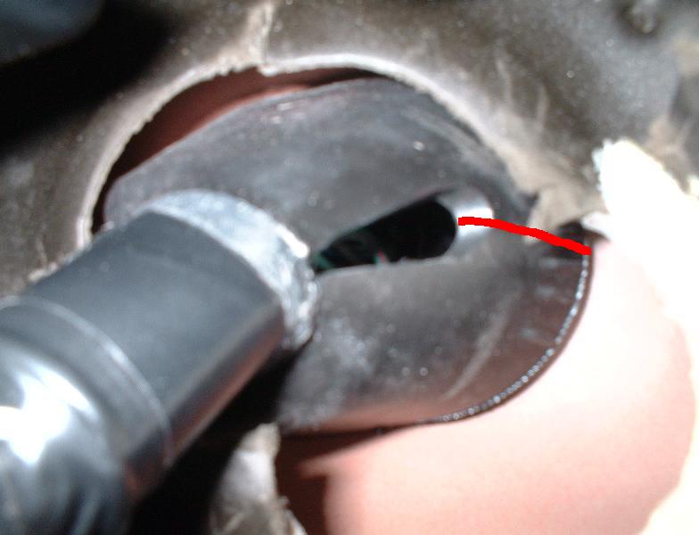

Ahh, it's not working. The huge rubber piece on the outside of all the wires takes up the entire hole. I tried putting it in through the slit in the rubber but the wires take up the entire hole on the inside. Here's a pic of what it looks like. Any ideas?

cut a slit in the outer rubber and run your wire there...

Hmm, I don't think I understand you correctly. Because if I cut a slit, the big rubber will still block up the entire hole. And the inside still has all those wires going through which takes up all the space on the inside.

let me go take a pic from the engine bay...

it was hard taking the pics...
i hope they help...
i just cut a hole in the rubber and it fit for me...
made it through no problems...
wish i could help you more...

Did you cut it like this?

yeah, cut a hole like that...
there are two boot covers...
one more is inside the engine bay...
stick a screwdriver(long one) through the hole then go look inside the engine bay so you know where it comes out...
make sure to fix the boot back up when you're done...

don't worry too much about the boot you're looking at now...
make the hole as big as you need...
if you mess it up you can fix it so now air gets in...
you really need find that other boot on the firewall...
it is a pain in the ***...hard to break through...
good luck!
