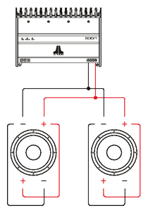

can someone draw a diagram because all this talk makes no sense to me! hahahahahahahahahahaha

http://www.bcae1.com/images/gifs/spk2dvcs.gif

which one of these is better?

Neither, it depends on the amp. 2 ohms, 4 ohms, 8 ohms, none is better than the other ..... Where it matters is how its all connected to the amp.
Take this amp:
500x1 @ 2 ohms
250x1 @ 4 ohms
125x1 @ 8 ohms
Now for this amp what would you get? Personally I'd get a DVC 4 ohm sub, wired in parallel so it acts like a single 2 ohm sub, and gets all 500 watts. If you wired that same sub in series, it would act like a single 8 ohm sub, so it would only get 125 watts.
You want to consider the number of subs and the ohms so that when you do hook it up you can get to the lowest ohms that the amp is rated for.
Most monoblock amps put out max power at 2 ohms. Some of the new ones put max power at 1 ohm. If your amp is geared for max power at 2 ohms, but you wire it to 1 ohm, you will most likely fry the amp. Higher ohms than the amp is rated for is ok, the amp just puts out less power. Lower ohms than the amp is rated for is bad. The amp tries to put out more power, and fries itself.

you seem pretty knowledgeable about this. in my first post you can see what i have, can you set me up with a diagram?

Use this diagram here
That amp still isn't big enough to give those subs the power they will need, so you may experience clipping. If it is not too late, I would go for a more powerful amp that will put out at least 600-800 wrms.
