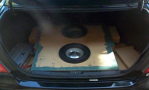

Rufus's Avatar
Posts: 9,137
From: Ontario
Rep Power: 381
4.1 Cubic feet/ 2 Diamond TDX-104's tuned with a slot port to 35Hz. Powered by a JL 500/1. With the moonroof open it looks like the sunvisors are waving at me. Pretty loud.
Oh and the spare tire is going under the car.
