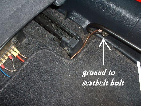

here you go winnerpl..

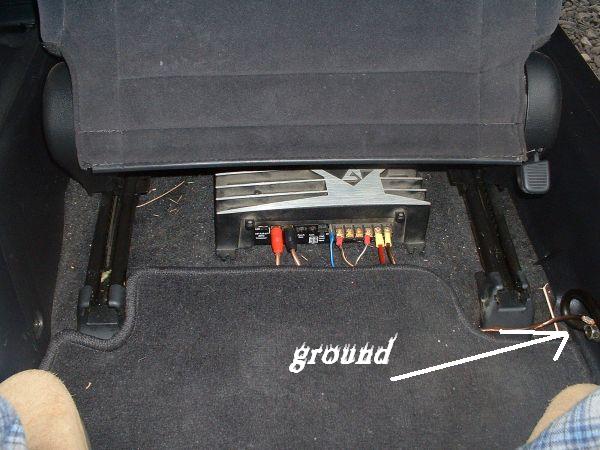

Old May 15, 2004
civic2uner's Avatar
Posts: 1,207
From: Arkansas
another
Old May 15, 2004
Hcivic01Vtec's Avatar
Posts: 63
From: texas
Hcivic01Vtec is an unknown quantity at this point
yeah this is not recomended, the amp gets too hot at times. If you could come up with some way to get a fan (better air flow) down there then maybe. But like kaZell said people kick it and could kick the wires off the terminals.

bad idea
heat
dont listen to anybody whos install looks like civic2uners there
