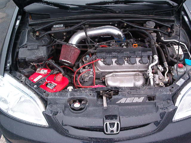

This is a really straight forward DIY with little complexity for an Optima Red Top
My stock battery went throught a terrible winter this year and a few weeks ago it was barely generating enough juice to turn my car over. I searched around and found that Optima had the best reputation. Optima has a yellow top battery which fits our civics, group 51 size. This battery offered substantial power over stock for running car audio with the car not running, called a deep cycle battery. However, I needed a starter battery with some life and a lot of CCA (cold cranking amps) due to the weather and frequent start and stop driving style. I decided to go with the Optima Red Top battery line. The model number for this battery is 9004-003, at it fits our civics. This specific application offers 980 CCA and 112 minute standby time with over 9000 starts, and side terminals for accessories like an amp. The stock battery size 51 offered 440 CCA on my 01 Civic.
1. Disconnect the (-) battery cable and then the (+) battery cable. Pull these off to the side.
2. Undo the stock battery tie down using a 10mm wrench on both ends.
3. Take the stock battery out. Remove the battery box. Remove the battery platform.
4. Drop the Optima in with the (+) node to your right.
5. Take the stock tie down and bend the tab back flush with the piece. Or you can buy a DC or STR tie down.
6. Bolt the tie down to the frame first then tug tie down the back end of the tie down.
7. Reconnect the (+) cable and then the (-) cable.
8. Run the car for 15 minutes to reset the ECU.
I noticed that the car turned right over with no hesitation. Also, the car seemed to idle much quieter. Headlights also do not dim when thumping the stereo and I do not have a cap on the system. I hope this helps when looking for a new battery.

Looks like you have a new ground control unit , is that correct?

Yeap, thats an arospeed ground kit.
