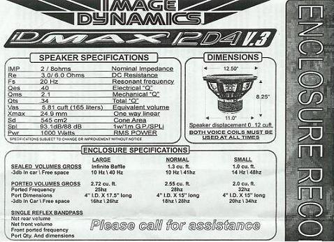

i never saw this sheet til i got my sub

rest of sheet.........

that sheet is available on image dynamics' website

that's good they put the sheet on the site i guess.
