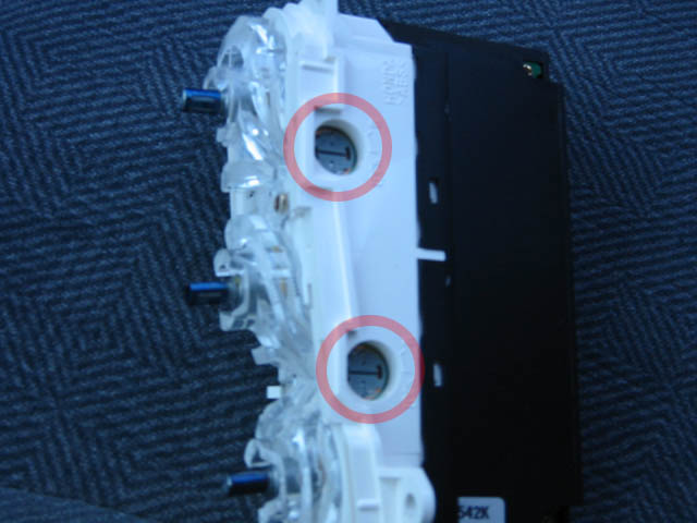

does anyone know what size bulb goes in the Ac....and the small three little buttons...
are they same bulb that goes on the Speedometer a # 74 bulb

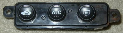

and these too.....

AC lIGHt replacement....help
Old Feb 10, 2004
Rep Power: 812
I also did a LED swap for the AC controls. Did you want the stock bulb sizes? I can check later tonight since I took them out. Just need to search a little.
Or you can just wire in some LED lights any color you want.
I'll take some pics for you later.

Well, it looks like the bulb is a part of the holder. The grey ones are for the control *****, and the long white ones are for the buttons. As a comparison, the big bulb in the white holder on its side is for a 2002 gauge cluster. The blue one is a #74 bulb for a 2001 gauge cluster. Your best bet is to see if Honda has the whole assembly.

would the 74 bulbs fit on any of the holders....i got the blue one you
have on your picture...actually its hyper white...and i also have the
other 74 bulb hyper white the ones that were to 2.50.......
let me know...again...

The 74 bulbs are too long to fit the holders. And besides, the bulb wiring is actually wrapped around the holder so that it makes contact when twisted in. They are all different sizes. Maybe you could try and do a custom job, or try and wire the bulb in without the holder. Would take some effort.

are the gray ones for the three little buttons.....and the long ones are
for the big ***** that turn the ac on...????
Old Feb 11, 2004
Rep Power: 812
No. Grey ones are for the big *****. White ones (long) are for the three buttons.

anybody happen to have a spare orange/red one of those long white bulbs for the buttons? I can't stand the green AC light, it contrasts way too much with the rest of the nice interior on my coupe! pm me please.
Old Feb 11, 2004
Rep Power: 812
The orange and green lights are actually LEDs and not bulbs. My interior is blue now and I still have that green light in there. You could just get another LED and try to install it.
