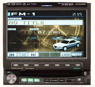

I run components in the rear deck and love em'. Run a good set of kicks and some tweets in the a-pillar and you won't have to work about your front stage. Good call on the amps, JL is great quality and efficent. Red Top Optima is what I run too. I have the D900. I recommend it over piece-mealing the system. Just do it all at once.
