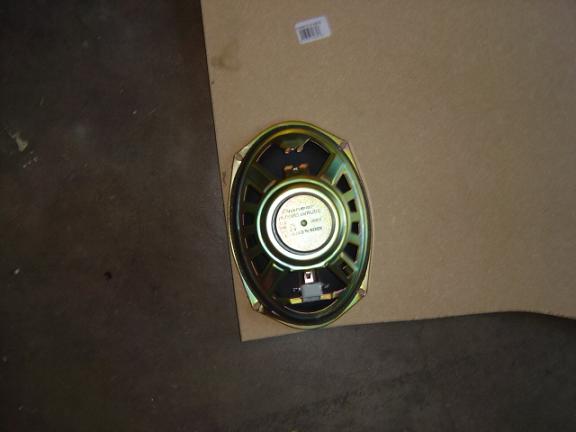

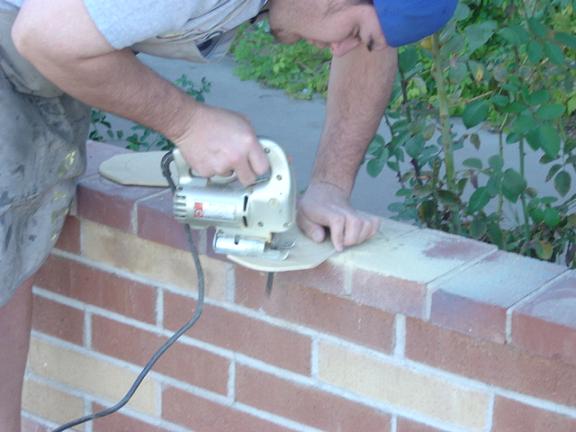

then act busy and make your friend cut them out..lol

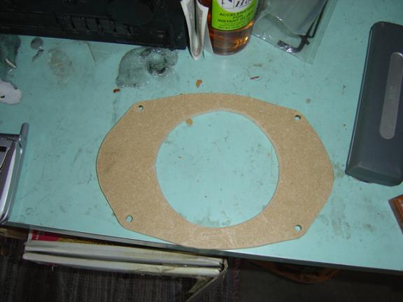

then u get two of these.

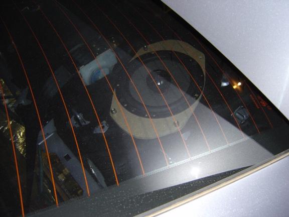

then put em in the car

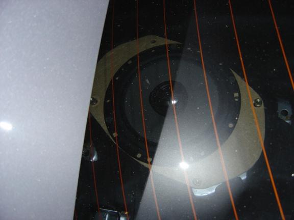

on both sides.

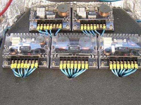

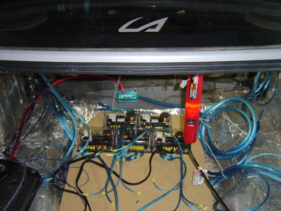

then add some wire and crossovers

more of the same.

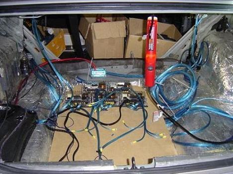

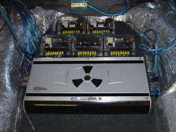

im done with the showy install...this board will hold my crossovers and amps and be hidden by the stock carpet. it will be easy to work on and and easy to work with if i want to put different amps in .....i might carpet it...thats about as showy as this amp rack will get..
questions??

finally...have speakers all around, big 4 channel amp, all wired and awaiting me to build my box for two 15s and put my other lightning amp in there..theres no substitute for power...sounds awesome with 200 watts to the each set of front speakers and 100 to the each rear. i also had to take the amp apart so that i could flip the logo and the top plate...i wanted the speaker and power inputs on the right side instead of the left.

I'm surprised nobody is bashing the Lightning Audio stuff. I'm not saying its bad, I personally think its decent and you have their higher end stuff it looks like right? Most people hear Lightning Audio and they cringe, but that looks like a well built amp
Old Dec 2, 2003
iLLuMiNaTi's Avatar
Posts: 405
From: Palos Verdes Estates
iLLuMiNaTi is an unknown quantity at this point
heard lightning's getting actually pretty good (their amps at least).. nice setup man!
Old Dec 2, 2003
alex053's Avatar
Posts: 5,054
From: Peoria, Arizona, US
Rep Power: 338
ya..people that only know bolt stuff tend to bash it...but i have seen the bolt stuff outperform JL e series stuff....the storm amps are strong....amp puts out 164x4 @ 13.8 @ 4 ohm...as far as work....did it in about 3 hours...just cut the wood, drill some holes and glue some carpet...nothing special..just got tired of looking at everything in the corner of my den and telling myself i would make something cool.....time to start enjoying what i bought.

whats the 5th crossover for?

The 5th crossover is probably for his add-a-woofer for the fronts. Call the Honda dealer and ask what size the bolts are.

correct...the middle bottom xover is for my 6.5" midbass in the doors....mystic is a quart guy...w000t

I still don't understand the 5th crossover. Is there 3 woofers up front or what?

there is a 4 inch component set up front....thats two of the crossovers..like with any other set. the 5th crossover has left and right in, and left and right out...just for the left and right 6.5" ...they are for midbass only and are paralleled with the front component set to make a 2 ohm load for my front speakers.
