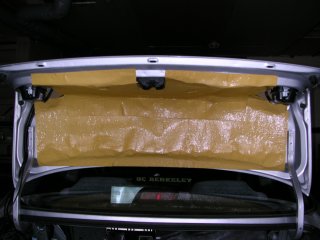

Hey guys,
I recently bought and installed a fatmat hoodliner (black urethane facing). The mat helped some with the engine noise, and it looks good under the hood. The only problem I'm having is some of the liner peeling off near the bottom from the heat. It still stays in place though. I would suggest putting the fatmat down while leaving some space on the sides. That way when you put down the foam layer, it will cover around the fatmat and hold it better. Overall, it's a good sound deadening mod that was only 10 lbs. It helps even more in the higher rpms (I was driving up a mountain around 5krpms and I could barely hear the engine). Buy the black foam liner instead of the aluminum--the black urethane version will absorb engine heat and look nicer under the hood. Let me know if you have questions.

The hoodliner starts to come off a little bit from the heat, but it still stays in place. It does make a good difference with noise.

Well, after reading this thread and having my problems with the FatMat I decided to e-mail them this request to ask for a refund (see below). I will post any follow up messages I have from them here and let you know if they do honor their 'satisfaction guarantee'
Hi the day after I received this e-mail from you last week I opened my hood and the liner had completely fallen off (all except for one small corner) and was sitting on top of my engine.
I did an internet search and I find that I am not the only one suffering from this problem. Please see the following link to a forum where users are discussing this very problem with your product:
http://www.7thgencivic.com/forums/sh...5&pagenumber=1
It was a severe disaster to remove the left over sticky residue left by the mat, and I still do not have it completely removed.
Given that your web site offers a money back guarantee, I would like to request a refund for this product.
I would also like to ask, can you recommend anything that will take the residual 'gunk' off the underside of my hood where the mat became unstuck.
I am really disappointed, because when it WAS stuck to the hood, this product did in fact work to reduce engine noise, and I was very pleased with this.
However, it doesn't stay stuck, not only to my car, but to others as well. Perhaps you can revise the product to make it more 'sticky' or provide some other means of adhesion.
In the mean time, please let me know that you do intend to honor your refund policy, and let me know the amount and date to expect the credit.
Thank you

Mine is half off already and peeling fast. Before I used to be able to press it back for a minute, but now it does not stick at all. I'm thinking about ripping it off if it gets any more loose.
As for the residue, I'm betting goo-gone would work. It'll just take time.

if it doesnt stick, theres nothing you cna add to make it stick. its not jsut adhesion you want, its cohesion, i tneeds to act as ONE MATERIAL to work right.
if a heatgun isnt enough to install it, you put it on with a blowtorch. and if the material wont melt on, theres nothing you cna do to make it work right.
i think the company is right, i think it was a matter of airbubbles. that with zero airbubbles, the liner wasnt going anywhere.

I'm sorry whiterabbit - I have to disagree on this one. I installed the hood liner per their instructions (which includes scrubbing the hood). I had no air bubbles under as far as I could tell.
However, I believe that some sort of adhesive material will work, since the back is just foam. Its not really coheasion which is holding this on, but just the sticky snot that they have on the back of the foam. The foam is what does the damping, of the soundwaves. The asphalt mat just changes the damping characteristics of the hood. I'm sure 3M makes some sort of adhesive which will do the job. Its sort of funny, but most of the fat mat which I purchased didn't quite stick when compared to the dynamat which I bought before trying the fat mat. I must say that I am disappointed in the quality of their product. I think its worth more to spend on dynamat vs fat mat (no odor with dynamat either - mine STILL hasn't gone away after 3 months!!!).
