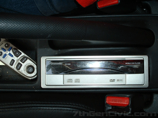

you could just put a dvd player there...like mine

here//

i dont want a dvd player there, i want the hu there, because i am f. glassing the stock location to flush in a monitor, which means the hu has to go... besides, my ps2 is going in the glovebox, and if i decide to do a dvd player/changer, it'll be under the seat, or in the trunk...
