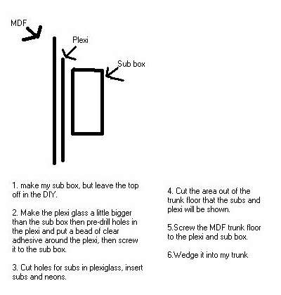

Like this?

if i were doing it, id do it somewhat like the drawing. naturally, there woul be a hole in the trunk floor, the same shape as dereks. the plexyglass would be .75 inch thick, a big square, with the cutouts and holes drilled.
id have a plastics shop do that for mey, they will easily do any sort of work like that and more!
id either use white plexi ot clear with a heavy blue tint, plastics shops have all sorts of plexi to choose from. looks like derek has a translucent blue.
the box would either have no top, or a top with a hole cut in it, and the plexi sitting over that. youd never see the border, teh trunk floor would rest on top of that.
the trunk floor would be padded by its carpet and rest by gravity over the box. the plexi would be bolted using machine screws.
so would the subwoofers.
then add neons!
