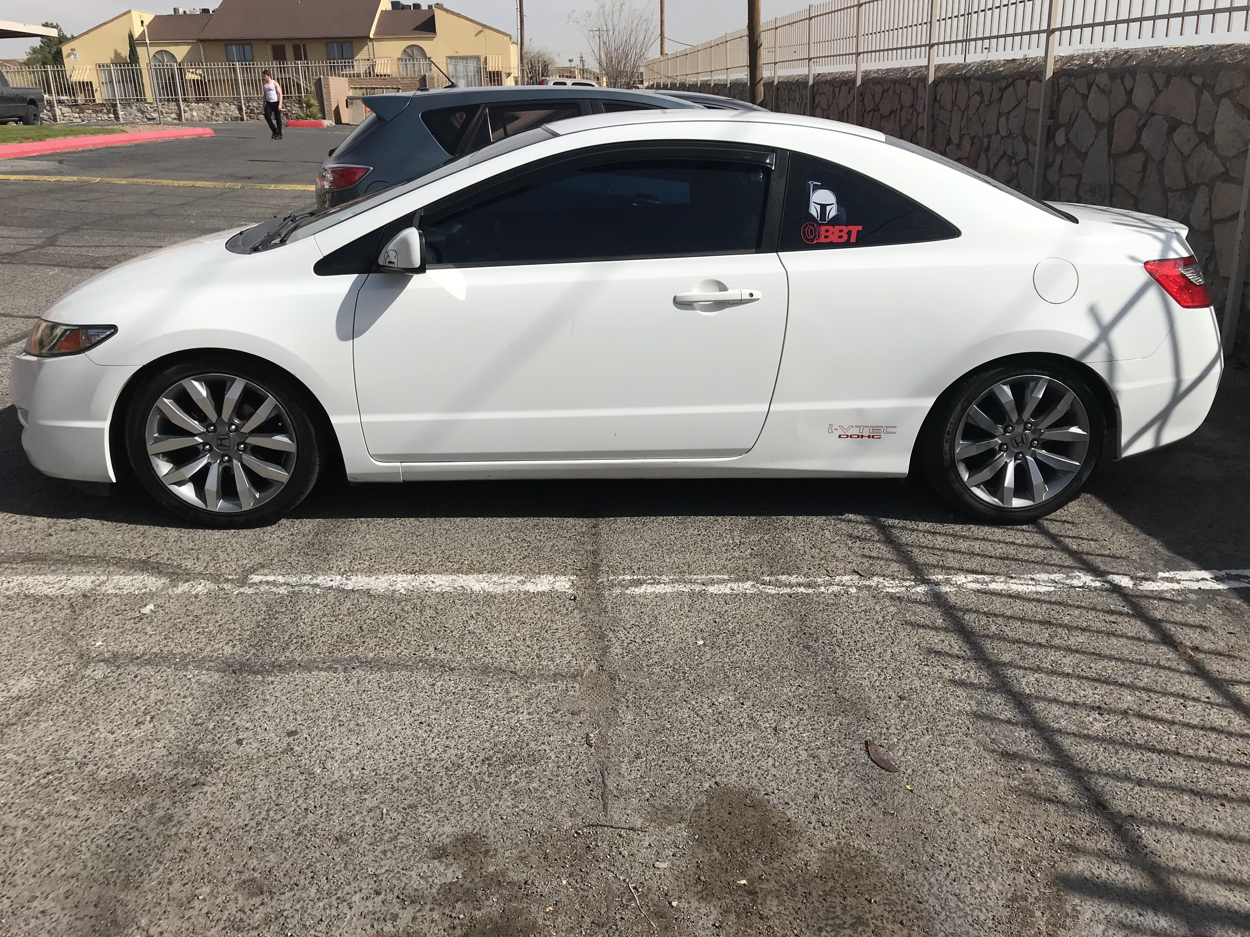

I purchased a used 2009 Civic Coupe LX for my son (It needs a little work, but was a great deal). The previous owner lowered the suspension by cutting the springs. My son and I both love the stance (height), but obviously it doesn't ride very good (to be honest, it's not really that bad), the original shocks/struts (134XXX miles) are long overdue for replacement. In addition, the previous owner installed 17" SI wheels, and there is some tire rub under certain conditions.
So I want to replace and upgrade the suspension but would like to keep a similar stance, improve the ride quality, and hopefully eliminate the tire rub.
My question is should I be looking at new OEM shocks/struts and proper lowering springs, or coilovers, or another option?
I like the idea of being able to adjust the ride height (coilovers), but ride quality for daily driving is more important than adjust-ability.
Budget for this is $600 - $800
I tried to include a picture, hopefully that's helpful.

I installed the HFP suspension kit this past weekend (Easter weekend). Install went smooth, took about 4.5 hours for all 4 corners. That was start to finish (setup to cleanup) 1 person, taking my time, using only basic hand tools and a scissor jack (no power tools or hydraulic floor jack), and I took a short break for lunch during that time. It was a pretty easy DIY, that anyone with a few hours and the right tools could do. It would probably take 1/2 that time with a floor jack and impact wrench. The difficulty would be the same with any suspension kit you choose assuming the front struts come assembled.
Here's what I think of it so far.... It's a fairly stiff suspension. I've ridden in a few cars with coil-overs (Godspeed, and Skunk 2) and I think the stiffness is similar to the coil-overs I've experienced. It's not bouncy at all, but is "bumpy", it's especially noticeable on rough patchy roads. I'm guessing it could soften up a little with use, but I'm really not sure. There's a noticeable increase in handling, the steering feels tighter, and more accurate; and the tires feel more planted onto the pavement, body roll is also noticeably reduced.
It did raised my car (I didn't take measurements), I now have a 2 finger gap, before (with the cut springs), the tires where tucked. I've read that it takes about a month to fully settle to it's final ride hight, so it may drop a little more (maybe 1/2"). Also, the suspension is much quieter than before. The cut springs made it quite noisy at times because they didn't fit tightly into the sprint seats.
All-in-all, I'm pretty happy with the suspension. I'm sure there are better options, as far as performance and/or ride quality, but this was what I felt most comfortable going with, and I'm glad I did.
