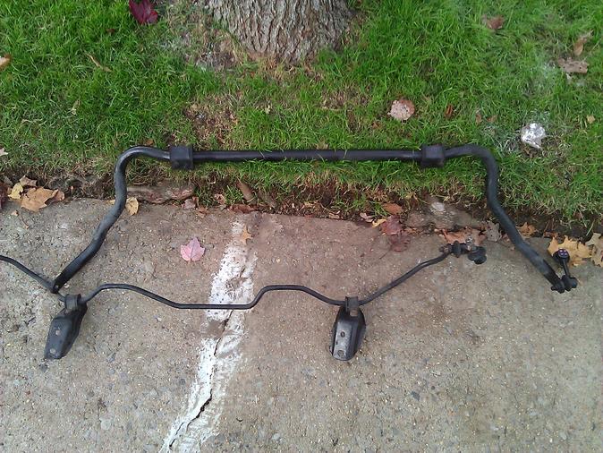

Actually 30 MM front and 19 MM rear.
the factory were 24 front and 11 rear- huge upgrade on the rear kills the tendency to understeer. Must be aware of this when driving.

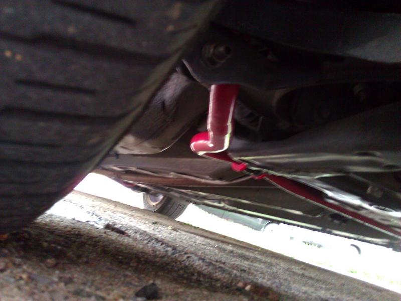

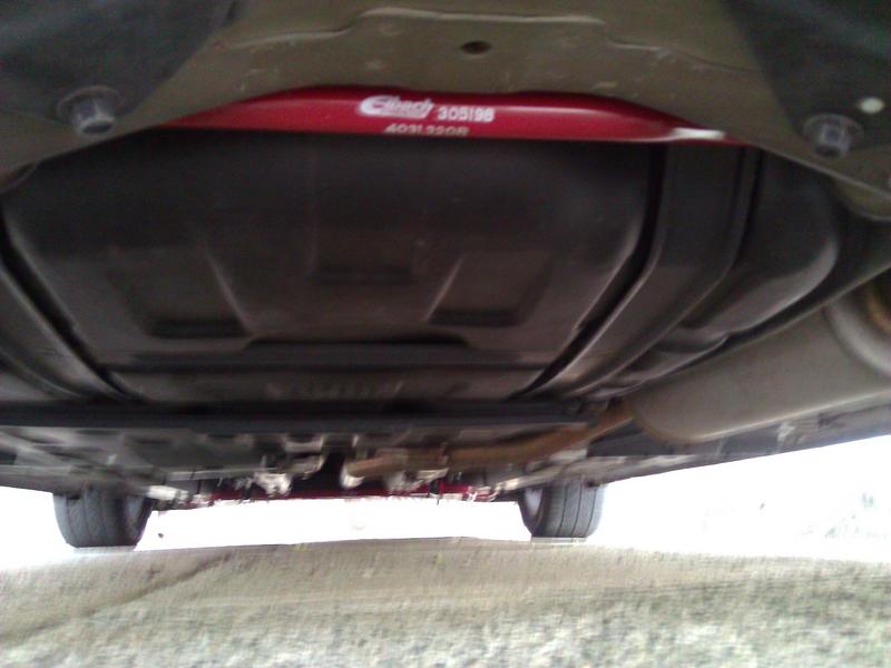

I have some photos i took with the phone...have to figure out how to upload here.
Old Dec 3, 2011
johng35's Avatar
Joined: Feb 2008
Posts: 143
From: Brooklyn NY
johng35 is an unknown quantity at this point
Re: 2008 EXL sway bar update
pics..
