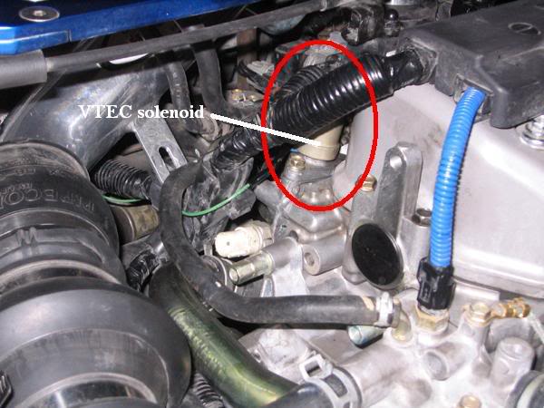

So the problem is just an oil leak?
It can leak a whole bunch because it's got full system oil pressure behind it.
You can replace 2 cheap rubber gaskets and that should seal it right up.
upper gasket, Honda part #36172-P08-015
lower gasket, Honda part #15825-P2M-005
From another post, with random goggle images:
This one has the top half of the valve circled, you can see where it lives on the engine
And the valve taken apart to replace the rubber gasket under the electrical winding portion in addition to the big rubber gasket that's easy to change
(do NOT lose any small parts or you will be buying the entire valve)
